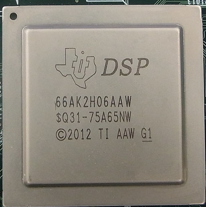

Hello Koichiro,
can you please let us know the orderable part number they used and a picture of the top of the package?
Hi Jeff,
Part number is 66AK2H06DAAW2.
I need to ask customer to take a picture you wanted.
Thanks and regards,
Koichiro Tashiro
