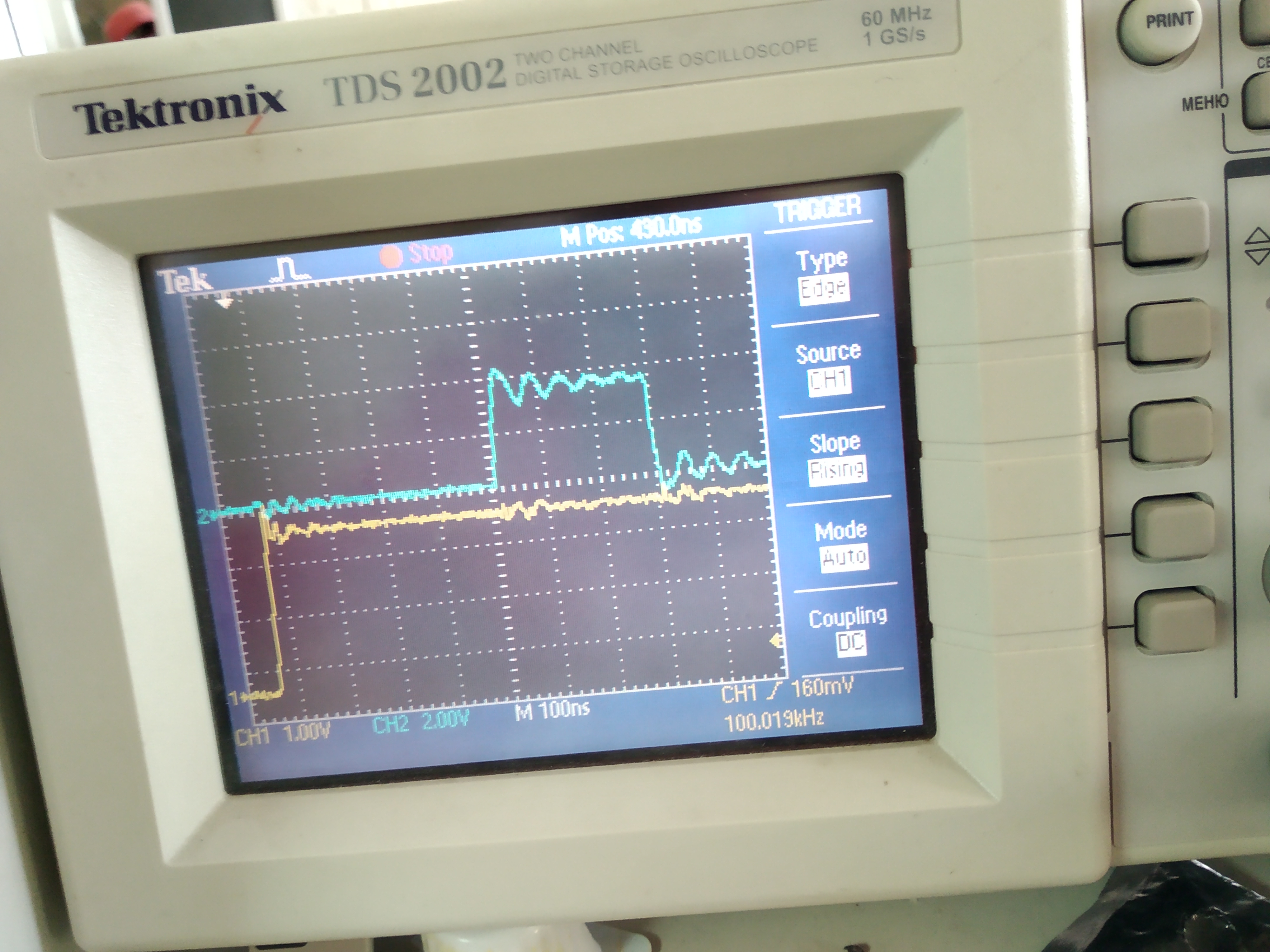

Hello!
Given:
1. CCS 9.0.1/CCS 9.3, pdk_am57xx_1_0_16
2. JTAG emulator: XDS220 ISO
3. Windows 7
4. AM5728, ARM frequency - 1.5 GHz
5. Pulse generator 100KHz
6. TI-RTOS
There is a code:

uint32_t gpio_base_address=CSL_MPU_GPIO2_REGS;
uint32_t gpio_pin[2] = {25, 28};

void AppGpioCallbackFxn()
//        GPIOPinWrite(gpio_base_address, gpio_pin[1], GPIO_PIN_HIGH);
    *(Uint32 *)0x48055194 = (Uint32)0x10000000;
    /*Disable interrupt*/
  //  GPIOPinIntDisable(gpio_base_address, GPIO_INT_LINE_1, gpio_pin[0]);
//    GPIOPinIntClear(gpio_base_address, GPIO_INT_LINE_1, gpio_pin[0]);
    *(Uint32 *)0x4805502CU = (Uint32)(0x02000000);
    /*Enable interrupt*/
    //GPIOPinIntEnable(gpio_base_address, GPIO_INT_LINE_1, gpio_pin[0]);
//   GPIOPinWrite(gpio_base_address, gpio_pin[1], GPIO_PIN_LOW);
    *(Uint32 *)0x48055190 = (Uint32)0x10000000;
Screenshot of the oscilloscope runtime code in function AppGpioCallbackFxn.
The blue line is the execution time from setting the pin to GPIO_PIN_HIGH and after removing the pin to GPIO_PIN_LOW.
As you can see, the execution time is 300 ns as seen in the screenshot. How can I reduce code execution time to at least 20-50 nanoseconds? Or is this already the limit of execution, what is impossible to further reduce the execution time?
Thanks!
