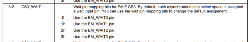

My customer has a question for C5504 EMIF EM_WAIT signals.
According to EMIF user’s guide (sprugu6b.pdf), Table 1-41, AWCCR2 register description,
EM_WAIT[3:0] pins can be mapped to CS[5:2].
https://www.ti.com/lit/ug/sprugu6b/sprugu6b.pdf
But datasheet sprs659g says actual pin names are EM_WAIT[5:2].
https://www.ti.com/lit/ds/symlink/tms320c5504.pdf
Customer wants to use EM_WAIT3 pin for CS3.
In this case, which one should be programmed in CS3_WAIT bit field in AWCCR2 ?
1h or 3h ?

    So the signals described in the EMIF User's Guide as EM_WAIT0, EM_WAIT1, EM_WAIT2, EM_WAIT3 are connected to the pins described in the TMS320C5504 datasheet as EM_WAIT2, EM_WAIT3, EM_WAIT4, EM_WAIT5, in that order.
    In that case AWCCR2 should be programmed so bit field [3-2] CS3_WAIT = 1h Use the EM_WAIT1 pin so that CS3 monitors the EM_WAIT3 pin. I believe CS3 could monitor any of the other wait pins: EM_WAIT2, 3, 4, or 5 by configuring this AWCCR2 register.
