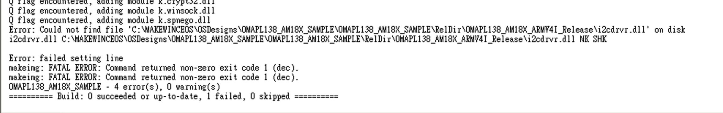

Hi Team,
My customer engineer had some issue which is refer to the screen image as below;
It seems to lose some file or develop tool , so they can not to done. Please help to check or provide this file if you have on hand. Thanks!

Hi Team,
Could anyone can help this case ? my customer still wait the answer from our side. Thanks!

Hi Eddie,
These files can be found here: http://software-dl.ti.com/sdoemb/sdoemb_public_sw/bsp/BSP_WINCE_ARM9/latest/index_FDS.html
