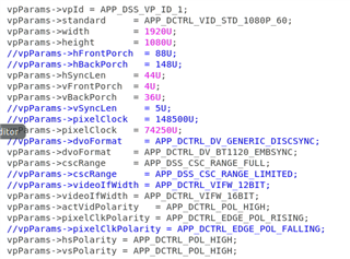

3、app_dss_defaults.c
·VOUT0/DP0

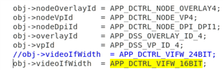

·VOUT1/DP1
4、app_dss_j721e.c
·VOUT0/DP0
·VOUT1/DP1

1、VOU0/DP0(74.25MHz 16bit)
·DSS0_VP_CONFIG(04AA0000): 03200000
·DSS0_COMMON_DISPC_CONNECTIONS(04A000E4): 00000002
·DSS0_VP_POL_FREQ(04AA004C): 00000000
·DSS0_VP_CONTROL(04AA0004): 00000141
2、VOU1/DP1(74.25MHz 16bit)
·DSS0_VP_CONFIG(04AE0000): 03200000
·DSS0_COMMON_DISPC_CONNECTIONS(04A000E4): 00000080
·DSS0_VP_POL_FREQ(04AE004C): 00000000
·DSS0_VP_CONTROL(04AE0004): 00000141

    Yes, I'm testing vout0 / DP0 and Vout1 / DP1 separately. I implemented vout0 / DP0 (bt1120 mode, VP2) in vision apps, but it was always abnormal when I changed it to Vout1 / DP1 (bt1120 mode, VP4). My final goal is to get both working simultaneously.

    Where to modify bt.1120 mode in vision_apps (16-bit mode or 20-bit mode)?
    I modified it in the following file:
    ti-processor-sdk-rtos-j721e-evm-07_02_00_06/vision_apps/utils/dss/src/app_dss_defaults.c
    After the above modification is successful, the corresponding position in the following register will change:
    Is the above modification correct? If wrong, where to modify it
    Looking forward to your reply!
    Thank you!
  • Hi hui wang,
    The API, appDctrlDefaultInit, In the file ti-processor-sdk-rtos-j721e-evm-07_01_00_11\vision_apps\utils\dss\src\app_dss_defaults.c initializes VP parameters by calling appDctrlVpParamsInit(&vpParams);. After this initialization, we need to change dvoFormat parameter of the vpParams to APP_DCTRL_DV_BT656_EMBSYNC/APP_DCTRL_DV_BT1120_EMBSYNC for BT output format.
    vpParams.dvoFormat = APP_DCTRL_DV_BT1120_EMBSYNC;
    Can you try with above change?
