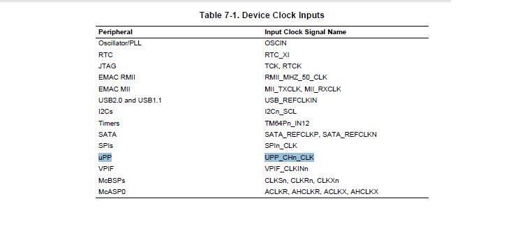

I have a problem with the configuration of the uPP-Port of my OMAP-L138. I want to read data from a AD-Converter that doesn´t provide a clock. Can I solve the missing-clock problem by somehow generating the signal on my own? I´m using the OMAP-L138 on the LogicPD eXperimenter-board and I want to use the ads8482.

    CLOCK pin, or I/O clock, is obtained independently based on its operating direction.
    Source is synchronous clock signal.
    In transmit mode, CLOCK is an output signal.
    In receive mode, CLOCK is an input signal.
    For more details, Refer the section "7.3.5 uPP Clocking" and "33.2.1 Clock Generation and Control" at OMAPL138 TRM(spruh77)

  • But can i generate a clock, when i use both channels in receive mode? The problem is, that i dont get a clock from my ADC.
