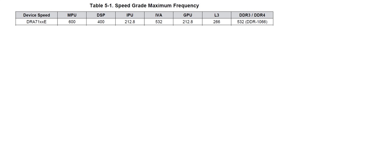

we are using DRA714 SOC for our board which requires Frequency scaling support.
As per the datasheet, the maximum frequency supported  for MPU is 600 Mhz.

But for DRA714 SOC the maximum frequency to be set is 600 MHZ.
Question/Request.
  1. Please provide us the OPP values for 600Mhz for DRA714 SOC ?
  2. What is the maximum frequency MPU in DRA714 can be used, Can it run for 1 Ghz only during the boot up time ?
