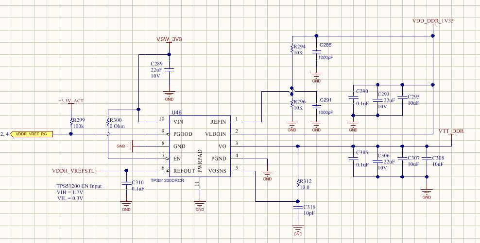

Could you please check the settings in the attached EMIF Config file.
Using Micron MT41K256M16TW-107 XIT:P
Attaching EMIF config file, and schematic page.

    -Have you checked board voltages, especially VDDR_VREFSTL and VTT_DDR

    Yes, board voltages have been checked,including sequencing.

    -I don't see the VTT regulator in the schematic snapshot you sent me. Just double check the VREF is properly connected from there and that VTT and VREF voltage values are valid during the leveling.
    James
    I have checked this, and they look good, including the sequencing.
