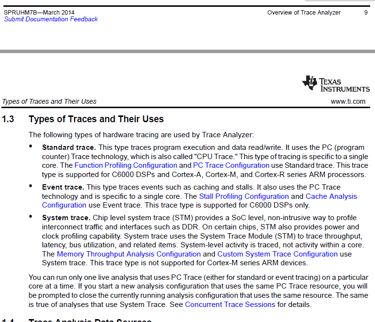

    Q.
    From debugger side, I think both TMDSEMU560V2STM-U and TMDSEMUPROTRACE supports, both ETB and STM. Is it correct?
    Q.
    SPRUHM7B.pdf - chapter1.3 tells three trace types.
    I think both TMDSEMU560V2STM-U and TMDSEMUPROTRACE supports all the three trace types, (Steandard, Event, System) for AM57xx. Is it correct?
    Or, (Steandard and Event) trace types are note supported by TMDSEMU560V2STM-U ?   (SPRUHM7B.pdf - chapter 1.5)
