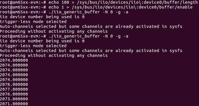

We are working on ADC with the SDK v06.00.00.07
The configuration for ADC has been done correctly in the SDK. I tried to supply voltage to one of the ADC channels. However, I am only getting two digital values, i.e. 0 for any voltage less than 0.9V and 4095 for anything above 0.9 V. What might be the reason for this behaviour?
