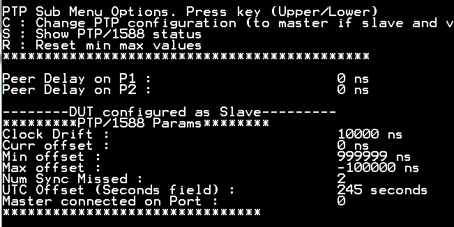

    Thanks for providing the doc. But it only described the function of TimeSync example, there is no detailed steps for how to run this example.
    Customer did the following steps:
    1. using ethernet cable to connect IDK board  PRUETH0 to PC
    2. Configure PC IP address to the same subnet
    3. Run ptpd on PC
    But the "offset" and "delay" are not correct.
    Thanks.

    The TI-RTOS timeSync example is tested with ptpd from Processor SDK Linux instead of PC. From the PTP status ('S'), we expect the the clock drift to settle to low values such as < 100 ns indicating the PTP sync.

    Can you please check if your NIC has hardware clock support or not?
    :~$ethtool -T eth1
    Time stamping parameters for eth1:
    Capabilities:
    software-transmit (SOF_TIMESTAMPING_TX_SOFTWARE)
    software-receive (SOF_TIMESTAMPING_RX_SOFTWARE)
    software-system-clock (SOF_TIMESTAMPING_SOFTWARE)
    PTP Hardware Clock: none
    Without PTP hardware clock support, you might observe the large clock drift.
    Garrett
  • Thanks!That's the reason....

    Can you try to run ptp4l/Ubuntu as master with the following command and configuration file ptp_cfg2.txt? The IDK board is set up as slave by default:
    ~/ptp41_test$ sudo ptp4l -2 -P -f ptp_cfg2.txt -m -H -i eth0
    ptp_cfg2.txt looks like below:
    [global]
    tx_timestamp_timeout 10
    logMinPdelayReqInterval -3
    logSyncInterval -3
    twoStepFlag 1
    summary_interval 0
    [eth0]
    egressLatency 146
    ingressLatency 246
    The result captured on my setup:
    Peer Delay on P1 :                      338 ns
    Peer Delay on P2 :                      0 ns
    --------DUT configured as Slave---------
    *********PTP/1588 Params********
    Clock Drift :                           5 ns
    Curr offset :                           -3 ns
    Min offset :                            -154 ns
    Max offset :                            60 ns
    Num Sync Missed :                       6
    UTC Offset (Seconds field) :            1568750807 seconds
    Master connected on Port :              1
    Garrett
