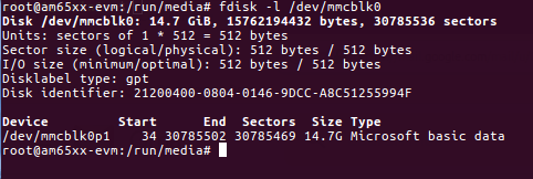

  1. To copy the filesystem they will be using the RootFS available in the SDK, i.e tisdk-docker-rootfs-image-am65xx-evm.tar.xz. When they scan the drive, they can only see only one partition that has been created. Is this the partition where they need to copy the RootFS?
   If the answer is yes, then they are unable to mount the drive to check the contents due to the following errors.
They thought is that they are getting this error since the drive is a GPT type partition.
To fix this, and continue with the configuration, will either below command work?
 root@am65xx-evm:~# dd if=/home/root/tisdk-docker-rootfs-image-am65xx-evm.tar.xz of=/dev/mmcblk0p1 bs=1M && sync
or
root@am65xx-evm:~# dd if=/home/root/tisdk-docker-rootfs-image-am65xx-evm.ext4 of=/dev/mmcblk0p1 bs=1M && sync

    A : To boot the kernel, u-boot needs to find the corresponding files/images from the /boot/ folder of the rootFS partition. In order that to happen, I need to extract the files from the tidsk-rootfs and store the file contents to the rootFS partition. Currently I am not able to load any type of tisdk-rootfs files to the rootFS partition as its not visible from user space.
    2)      You can access the bootloader images from user space via /run/media/<device>, let me know if this works
    A : I can only see the bootloader partition created in SD card not in but not in eMMC as eMMC partition is not getting mounted. PFA.
     You can see this is the eMMC partition that I am getting which i created while following the SDK commands. PFA.
