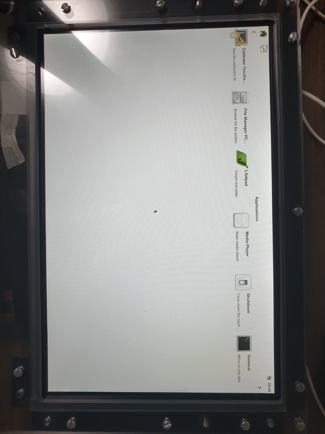

i built Yocto project at TMDX654GPEVM and boot up
so i can see this page
but touch screen did not work

    What version of the SDK are you building?
    When you use the out of the box software, does the touchscreen respond as expected?
    Nick
  • thanks to reply
    i used lastest bsp version from openembedded.org
    and create-SDcars.sh from Ti website
    i tested touchscreen that prebuilt-image from Ti demo
    and touchscreen is work very well

  • Hello Nick
    I need more help to this problem
    I used Ti-BSP from http://git.yoctoproject.org/cgit/cgit.cgi/meta-ti
    And I built am65xx-evm.conf
    I posted the script in the first post.
    I Checked MACHINE_FEATURES += "touchscreen"
    And then I can made Yocto Build image.
    And I was download PROCESSOR-SDK-LINUX-AM65X from http://www.ti.com/tool/PROCESSOR-SDK-AM65X
    I used  create-SDcars.sh included in the PROCESSOR-SDK-LINUX-AM65X
    but I had problem and posted this forum  "TMDX654GPEVM: I Can't Boot up Yocto Custom Linux" and solve problem
    finally I can boot up Yocto image. but didn't working touchscreen.
    I already boot up Prebuilt image from Ti, when touchscreen working
    thanks to read, and if you want more information please Reply Say to me
    if I solve myself, I will write solution.
    I wait your Reply, have a good day

  • As a further consideration, the white background yocto I posted first did not perform the calibration of the touch screen.
    I checked your manual (software-dl.ti.com/.../How_to_Guides_Target.html and found that calibration is needed.
    If so, how do I run it initially like the matrix image provided by Ti when I run yocto?
    My guess is that I have to put the corrective code in conf / bblayers.conf, but I couldn't find a description of it, and I couldn't find it because the bblayers.conf inside tisdk was written in a huge folder. I would like to ask for a verification and my method.
