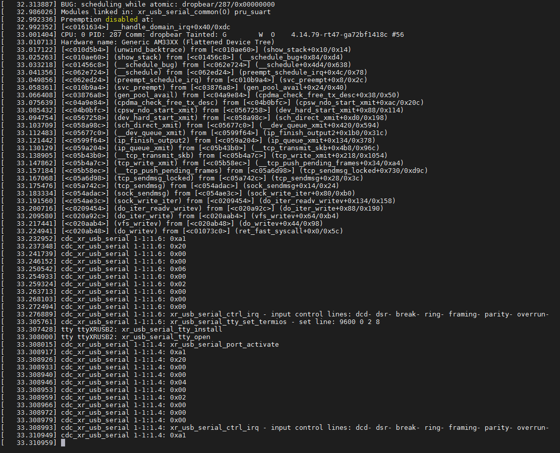

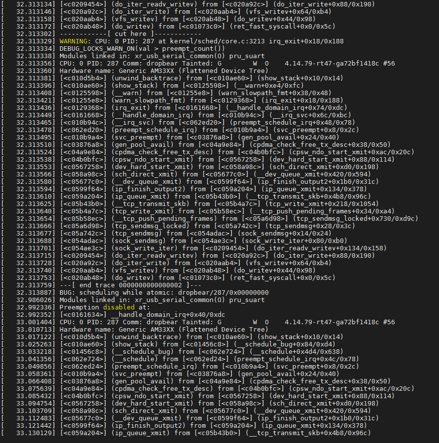

  • This issue is related with RT-Preempt patch's threaded interrupt handler mechanism.
    The crash bug report shows suart driver's irq handler is in IRQ context, even if it's a full rt-preempt system. In the isr, the call stack is:
    pport_handle_irq()
    pport_rx_chars()
    tty_flip_buffer_push() ==> which calls rt_spin_lock_slowlock_locked() then calls schedule()
    all these functions are running in IRQ context, not thread context, so the preempt_count's hardirq bit is set to 1, schedule() triggers BUG_ON() report.
     In my opinion, the key to the problem is the IRQ handler is not threaded in RT-Linux.  When I change the irq_flag to IRQF_TRIGGER_RISING, the handler is registed as a kernel thread, the problem solved.
    The patch file is attached, which contains another fix to driver probe issue.
    If you confirm the problem, please let me know asap.
    Thanks.

  • Hi Dachuan,
    Thanks for the patch, but I am not sure it is the proper fix for the issue. It seems it only covers the issue probably due to timing change.
    How do you do exactly to trigger the issue? I'd like to reproduce it on my setup and debug it.
    And thanks for the DEFER probe fix in the patch, I will ensure the fix get into the next SDK release.
    For my curiosity, why to do remove the nr_pins checking as in the patch?
  • Some functions called by pport_handle_irq() may be not IRQ safe, and should be called in bottom half of the interrupt.
    The issue may be triggered by opening and sending/receiving mass data through ALL pru suart ports AT THE SAME TIME.
    Our board has 3 pru suart ports, 4 built-in uart ports and 4 usb2serial ports. I create a test to use these ports simultaneously, it's very easy to reproduce the issue.
