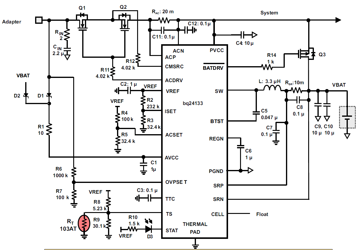

    Datasheet section 9.3.1.4 Converter Power-Up gives more detail about soft start.  This applies to all of our NVDC power path chargers.
    If your system can run at input adapter voltage = 5V, can you use a charger like BQ24133 below?  Q1 is for soft start which you may not need and Q2 could be replaced by a diode for reverse blocking.

    Suggesting an alternative part is not really solving the problem.

    If you want to use the BQ24296, you may be able to add an external PFET between SYS and the 2.35 ohm load.  Then you can add external resistors and capacitors to soft start the PFET similar to what is shown in figure 2 of the app note below:
