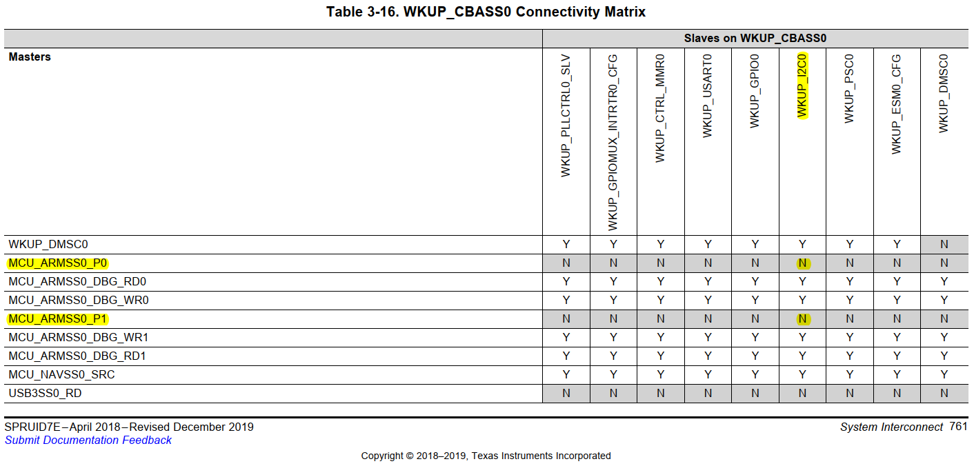

  • Hi Dave-san,
    Thank you for your reply.
    Dave Bell said:
    For the I2C question,  yes the R5F CPUs are able to access the WKUPSS I2C. See Table 3-16 of the TRM: WKUP_CBASS0 Connectivity Matrix.
    I checked the WKUP_CBASS0 Connectivity Matrix. There is no connection between MCU_ARMSS0_P0 or MCU_ARMSS0_P1 and WKUP_I2C0.
    Is my understanding incorrect?
    Daisuke
  • Daisuke-san,
    The access is through the RD and WR ports from the R5. There are three interfaces to the system, described in section 6.3:
    6.3.3.3 MCU_ARMSS Interfaces
    6.3.3.3.1 Master Interfaces
    The MCU_ARMSS has two master interfaces per CPU:
    • 64-bit VBUSM master pair (1 read, 1 write) for L3 memory accesses; this is the main memory interface
    – Includes region-based address translation (RAT)
    • 32-bit VBUSP master for peripheral access
    – Includes logic that provides the R5F CPU with a private access to VIM and RAT
    – Enabled at reset
    Dave
  • Hi Dave-san,
    I understand as follows:
    MCU_ARMSS0_Px:  32-bit VBUSP master for peripheral access
    MCU_ARMSS0_DBG_RDx: 64-bit VBUSM master for L3 memory read
    MCU_ARMSS0_DBG_WRx: 64-bit VBUSM master for L3 memory write
    Our customer will refer to the source code for J721E SoC to access WKUP_I2C0 for controlling the MPU voltage regulator in the bootloader on R5.
