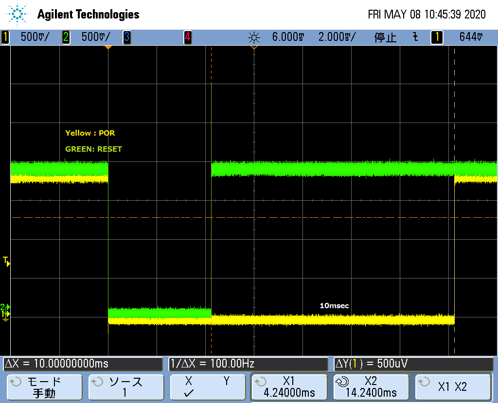

Our customer is developing system board with TMS320C6457, customer encountered the problem which was related to POR.
This board is working fine after system power-up, however, when POR was executed after system power-up, system seems freeze as follows (Power is keeping to supply). Although I requested customer to capture RESETSTAT in addition, RESETSTAT terminal was implemented as N.C, unfortunately. Customer is using EMIFABoot mode.
As far s I checked datasheet[7.6.1 Power-on Reset], it seems, device power-up cycle is not required to initiate a power-on reset.Is there any limitation for POR execution? If customer wants to do system-reset, should they initiate “Warm Reset”?

    The POR and RESET signals shown look like they are valid based on the timing shown in the data manual.  Applying a POR after the power supplies are present is also valid.  Does the clock continue through the reset pulses?  Can the customer probe the EMIFA address and control signals to see if the device attempts to reboot?

    Thanks for your comments on this. I’m requesting customer to probe AECLKOUT pin of EMIFA. Is that O.K? And then, although I requested to probe the EMIFA address and control signals, it seems customer is not able to do it on their board.

    The AECLKOUT is not the best signal to probe.  It's only present if they are using synchronous memory and it is just a clock output.  Better signals would be the CE and one of the lower addresses of the boot memory.  If the CE is active and the addresses are toggling than the device is attempting to boot from that device.
    Has the customer attempted to put a JTAG probe on the device after the reset is applied?  Can he read the DEVSTAT registers after power up and after the reset is applied to see whether the bootmode is latched correctly?  How are the GPIO pins shared with bootmode used on the customer board?  Another possibility is that the customer is using these as inputs that are driven by some circuit once the board is operational.  If the circuit driving these pins is not disabled when the POR is applied, the wrong bootmode may be latched.
