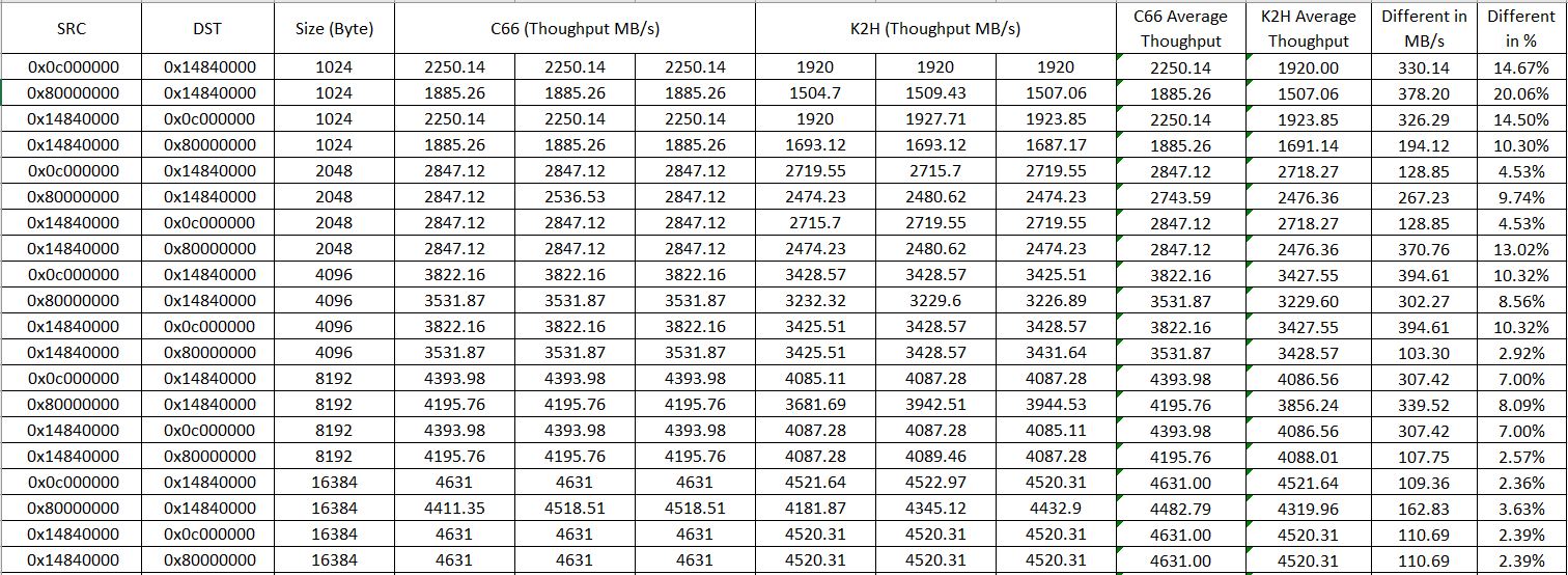

Do you have any benchmarking of EDMA between C6678 DSP and 66AK2H DSP?
I am using CSL EDMA example from processor SDK to evaluate EDMA on C6678 and 66AK2H (for both I am using evaluation board). My test result shows that C6678 DSP has shorter EDMA transfer time if both are running at 1GHz clock. Is it expected? And may I know th reason why.
I aslo check the troughtput performance guild (SPRABK5A1 and SPRABK5B), they show that:
For C66x:
For Keystone 2:
So for TC0, if they two DSP has same clock, which is 1GHz, they will have same theoretical max throughput at 10667 MBPS, but C66x has higher efficiency at 98% compare to 93% of Keystone 2. So can I say that if the two DSP has same clock, 66AK2H have slower EDMA compare to C6678?

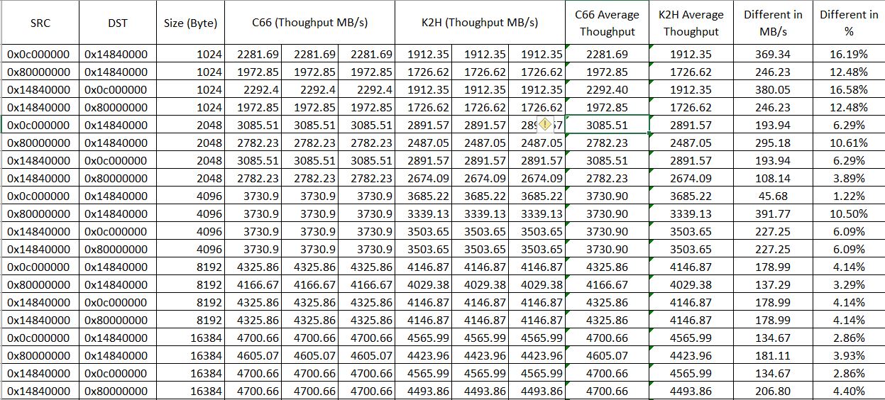

    So for the other question regarding my test reuslt:
    "I am using CSL EDMA example from processor SDK to evaluate EDMA on C6678 and 66AK2H (for both I am using evaluation board). My test result shows that C6678 DSP has shorter EDMA transfer time if both are running at 1GHz clock. Is it expected? And may I know th reason why."
    Is it expected, or any setting could result this?

    "I am using CSL EDMA example from processor SDK to evaluate EDMA on C6678 and 66AK2H (for both I am using evaluation board). My test result shows that C6678 DSP has shorter EDMA transfer time if both are running at 1GHz clock. Is it expected? And may I know the reason why===========>
    You need to explain what is the EDMA source address and destination address, is only one transfer in place or multiple in parallel? What EDMA CC and TC used? Are they the same DBS and FIFO size? If you make the transfer inside the corePac, e.g L2 to L2, do you see that C6678 is faster than K2H? How big is the difference?

  • Hi Eric,
    I use the ping-pong example from CSL package. the data is between L2 / SHRAM / DDR3B memory, the size of the data is 4kB (1024 DW). The test is using EDMA0, with different DMA/QDMA channels. The average result is as below:

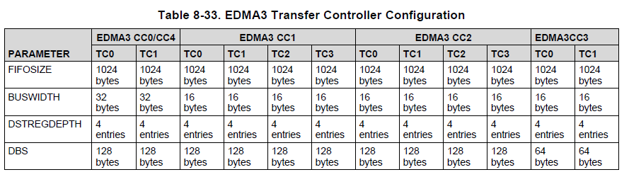

    I saw you used EDMA CC0, it has BUSWIDTH 32 and DBS 128. This is one of the best CC in all EDMA. This CC has 2 TCs, I saw you allocate all EDMA channels to TC1. This is not the good practice in real usage, it is better to allocate channels to alternating TCs. But in your test, it is OK given this is one channel followed by another channel test, without parallel transfer. TC0 and TC1 has the same property, use either should be OK.
    I tested your code with either TC0 or TC1 on K2H, the results are the same. K2H/C6678 has at least 16 DMA channels, I saw the results looping for 16 channels, and all the channels almost the same results.
    Your EDMA transfer data size is 1024/2=512x4 bytes, I wonder if this is for the test purpose or real usage case. Is that possible that you do much bigger transfer, e.g. 32768 bytes for bench-marking ?
    I modified your code to calculate the ping and pong results separately and also calculated the throughput. For big transfer (32768 bytes), the throughput is about 5000 MB/s, this is the number I expected. For smaller transfer (512x4 bytes), the throughput is about 2xxx MB/s, I am not sure about this number as we typically do big transfer.
    All my test is done on K2H, I set the CPU at 983MHz, approximately 1GHz. I don't have C6678 setup as I work remotely. I would like you to confirm:
    1) DDR3A or DDR3B, as there is no DDR3B in C6678
    2) If you can use much big transfer size for test?
    Then we can refine my test example. Attached is my test code and log file.
    Regards, Eric

    Now our numbers are aligned. For 2048 bytes, C6678 is ~700, K2H is ~900. For 32768 bytes, both are ~6600. The test is based on your code linked with respective CSL library.

    That is ~3% different.
    If you can confirm the number with my bare metal code, ~700 cycles for both. Then the K2H CSL library has problem to look into. Attached is my code and linker (everything in core 0 L2)
    Regards, Eric

     66AK2H12/14 Data Sheet
     Table 6-32 EDMA3 Channel Controller Configuration
     	 	 	 	  EDMA3 CC0 EDMA3 CC1 EDMA3 CC2 EDMA3 CC3 EDMA3 CC4
     No# channels     64        64        64        64        64
     Table 6-33 EDMA3 Transfer Controller Configuration
     	 	 	 TC0   TC1    TC0   TC1   TC2   TC3    TC0   TC1   TC2   TC3    TC0   TC1       TC0   TC1
     FIFOSIZE    1024  1024   1024  1024  1024  1024   1024  1024  1024  1024	1024  1024 		1024  1024
     BUSWIDTH    32    32     16    16    16    16     16    16    16    16     16    16        32    32
     DSTREGDEPTH 4     4      4     4     4     4      4     4     4     4      4     4         4     4
     DBS         128   128    128   128   128   128    128   128   128   128    64    64        128   128

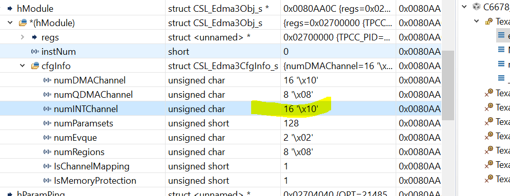

  • 3. Why C6678 DDR3<=====>MSMC is faster than K2H?
    I tested, this is only true for C6678 EDMA CC0, TC0 and TC1. For other EDMA CCx and TCx, the throughput is normal. The highlighted may explain this but not a quantitative way in C6678:
    For K2H, CC0 looks to be the same as CC0 in C6678, but the throughput is normal.

    For 2, "If you can confirm the number with my bare metal code, ~700 cycles for both. Then the K2H CSL library has problem to look into." ======> I used the C6678 binary (linked with C6678 CSL) run on K2H, I saw the number dropped to ~700. So definitely K2H CSL library caused this.
    There is only two API calls affecting the time benchmarking:
    • CSL_edma3HwChannelControl
    • CSL_edma3GetHwStatus
    How soon you can set the ESR bit and how fast you can pull the IPR bit. I compared the source for both functions on K2H and C6678, there is no difference.
    However, C6678 CC0 has 16 DMA channels,
    K2H has 64:
    This results in additional code execution in K2H CSL:
    case CSL_EDMA3_QUERY_INTRPEND:
    CSL_Edma3Obj* ptrEdma3Obj = (CSL_Edma3Obj *)hMod;
    /* Get the low pending interrupts. */
    CSL_edma3GetLoPendingInterrupts(hMod,((CSL_Edma3CmdIntr*)response)->region,
    &((CSL_Edma3CmdIntr*)response)->intr);
    /* Get the high pending interrupts only if they are supported */
    if (ptrEdma3Obj->cfgInfo.numINTChannel > 31)
    CSL_edma3GetHiPendingInterrupts(hMod, ((CSL_Edma3CmdIntr*)response)->region,
    &((CSL_Edma3CmdIntr*)response)->intrh);
    else
    /* Reset the high pending interrupts to 0. */
    ((CSL_Edma3CmdIntr*)response)->intrh = 0;
    break;
    That can explain the additional cycles as it also needs to read high channels, some extra overhead. Perhaps, you can directly pull the IPR register since you know which EDMA CC and channels are used, to replace the CSL call?
    Regards, Eric
  • Hi Eric,
    I change the CSL for 66AK2H project to be as below:
    But I still see the result is not improved. Do I miss any step?
    For your program, I try to run it with my existing project (just replace the source file, keep all the project setting to be the same), I still see the large different on the 2 processor. Can you advice how you test the provided program that has similar result in 2 processor? My test result is as below:
    Test_66AK2H.txt

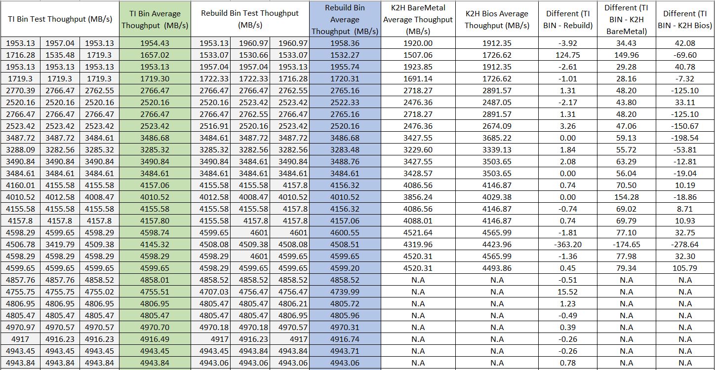

    Thanks a lot.
    You did what I asked to do, I am not sure why the results are different.
    I attached my CCS project, it also has a binary file built today, I used this file to re-run on C6678 EVM and K2H EVM and I also attached results. I didn't do anything special to build the project. Both test were on TI EVM in no-boot mode and with the default GEL file for SOC initialization.
    Are you able to load and run standalone without your other codes? And if the results are different, can you run a few more times?
    Regards, Eric

  • Hi Eric,
    Yes, I run the test 3 times and take the average.
    I also run your provided Bin file, and rebuild your project with CGT 8.3.4 (I do not have CGT 8.3.5). the result are as below:
    Below is my project (with the Bin file) for K2H Bare Metal and Bios, and also the Gel file I use to setup the board:
    K2H_DSP_BareMetal_Proj.zip
    K2H_DSP_Bios_Proj.zip
    1588.xtcievmk2x.gel
    Thanks.
    Your GEL file is the same as I used.
    Your Baremetal code is my test code built with #define K2H, the only difference I used 983.02 for throughput calculation instead of 1000 for C6678, this will make the K2H 1.7% slow down when comparing MB/s.
    I would like to use the cycle to compare C6678 and K2H, so we don't care about what CPU speed is. I ran the baremetal code you provided for K2H, the results are below:
    So, my K2H results for 4096, 8192, 16384 bytes are same as yours. For those 1024 and 2048 bytes where you have lower numbers, my results are better than yours. We exchanged the binary and source code, it is more likely the setup makes difference.
    Are you using TI K2H EVM? What is the silicon revision of the SOC? You can check the silicon errata document. And decode 0x0181_2000 and 0x0262_0018, my chip is PG 3.1.
    Regards, Eric
  • Hi Eric,
    For your result provided in the previous post for the size of 1kB, C66 also faster than K2H about 10%:
    Size (Byte) C66 (MB/s) K2H(MB/s) Difference Difference (%)
    1024 2250.14 1960.97 289.17 12.85%
    1024 1885.26 1722.33 162.93 8.64%
    1024 2250.14 1953.13 297.01 13.20%
    1024 1885.26 1957.04 -71.78 -3.81%
    This one should be review as well.
    And when I do the test multiple time, I observe if the test involves DDR3, test result's repeatability is not high. E.g. Data of 1kB from 0x80000000 to 0x14840000 has throughput for 3 times are 1716.28, 1535.48, and 1719.3 Is it the performance characteristic of DDR3?
    I am using EVMK2H board, reading from the 2 address mentioned shows my board is PG1.0. The tag on my evaluation board said it is Rev1.1.
    Thanks a lot.
    I thought we both put many efforts on this, with CSL level code, bare metal or SYSBIOS and with different runs to average the results. There is also some difference between my number and your number on K2H. I put my June 01 number below, yes, C6678 is faster than K2H in smaller transfer and this diminishing as transfer size growth. Regardless of different runs or your side or my side, we saw the same trend.
    SRC DST Tran Size (Bytes) C6678 CPU cycle K2H CPU cycle Diff
    0x0c000000 0x14840000 1024 434 500 13.20%
    0x80000000 0x14840000 1024 518 567 8.64%
    0x14840000 0x0c000000 1024 434 500 13.20%
    0x14840000 0x80000000 1024 518 499 -3.81%
    0x0c000000 0x14840000 2048 686 707 2.97%
    0x80000000 0x14840000 2048 686 774 11.37%
    0x14840000 0x0c000000 2048 686 706 2.83%
    0x14840000 0x80000000 2048 686 705 2.70%
    0x0c000000 0x14840000 4096 1022 1121 8.83%
    0x80000000 0x14840000 4096 1106 1190 7.06%
    0x14840000 0x0c000000 4096 1022 1119 8.67%
    0x14840000 0x80000000 4096 1106 1121 1.34%
    0x0c000000 0x14840000 8192 1778 1879 5.38%
    0x80000000 0x14840000 8192 1862 1948 4.41%
    0x14840000 0x0c000000 8192 1778 1880 5.43%
    0x14840000 0x80000000 8192 1862 1879 0.90%
    0x0c000000 0x14840000 16384 3374 3398 0.71%
    0x80000000 0x14840000 16384 3374 3466 2.65%
    0x14840000 0x0c000000 16384 3374 3398 0.71%
    0x14840000 0x80000000 16384 3374 3397 0.68%
    0x0c000000 0x14840000 32768 6398 6433 0.54%
    0x80000000 0x14840000 32768 6482 6779 4.38%
    0x14840000 0x0c000000 32768 6398 6501 1.58%
    0x14840000 0x80000000 32768 6482 6503 0.32%
    0x0c000000 0x14840000 65536 12530 12573 0.34%
    0x80000000 0x14840000 65536 12614 12711 0.76%
    0x14840000 0x0c000000 65536 12530 12643 0.89%
    0x14840000 0x80000000 65536 12614 12642 0.22%
    The DMA performance in the steady state are determined by the following factors:
    1. Speed and bus width of the memory end point (MSMC is CPU/2 in C6678, CPU/1 in K2H, DDR3 differs)
    2. TC’s bus width, burst size and FiFO size (we keep this the same)
    3. The intermediate path between source and destination with equal or higher BW provided for the memory end point
    If all three points are the same between two SoC, then the EDMA performance should be the same when it gets into steady state.
    For the particular one that MSMC<========>L2 showed +13% difference. I looked at the topology (you can find it in the system interconnect chapter of the datasheet):
    • For C6678, EDMA_0/TC0 is on TeraNet 2_A CPU/2 and MSMC SES on the same. L2 is on TeraNet 3_A CPU/3.
    • For K2H, EDMA_0/TC0 is on TeraNet 3_C CPU/3 and MSMC SMS on the same. L2 is on TeraNet 3_A-2 CPU/3.
    This is different inter-connection and can’t compare the numbers directly. Certainly, the slower of K2H on small transfer is not what you expected, but that is only dozens of cycles on a 1GHz CPU.
    One thing to highlight is that the SoC arch is intended to optimize the aggregate throughput and capacity for multiple concurrent traffic streams through the switch fabric, as well as the ability for activity to be separated to both maximize this concurrency and also meet critical deadlines. So looking at an individual data transfer doesn’t give a complete performance picture. Hawking has higher overall transfer capacity, more processing, and more memory.
    In addition, we are doing a SW-triggered transfer, so any additional cycle delay on the VBUSP path to the ESR will add an initial startup delay. If there is a change in VBUSM:M bridging between the TC master ports and the memory endpoint slave ports that will add to the start and end of the transfer. From a jitter standpoint, we are polling the EDMA ISR over VBUSP, so that’s a high-delay read. You’d expect this to average out over multiple runs though. But we could remove that part if routing to the CPU and polling the ISR.
    Let me know if you have further concern.
    Regards, Eric

    Regarding the result different on your board and my board when runing same program/setting, what could be the cause on that? Will it be because of silicon version different? I go through the silicon erata (sprz402f) but could not find any detail regarding the performance different.
    Beside those issue listed on the table, is there any advantage of PG3.1 compare to PG1.0?
    Thanks.
  • Chanh
    We strongly encourage you to get the latest EVM.
    If you are considering K2H for final application development and production, you will be using PG3.1 as PG1.x is no longer available/supported.
    There are some erratas, but we could not see any direct correlation. However it would be best to minimize any hardware and software differences, if you are still trying to dig deeper on this.
    We think we have provided sufficient guidance on this topic - and we definitely appreciate the thoroughness of your evaluation.
    Mukul
