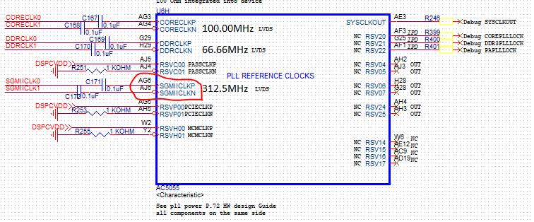

I didn't see it in the datasheet, what is it the PPM clock requirements for the inputs clocks?
for: SGMIICLK input clock and others :
Shay,
Please refer to chapter 3 in the Hardware design guide for KeyStone I devices Application Report (SPRABI2). It has the information required for the SERDES clocks.
Tom
