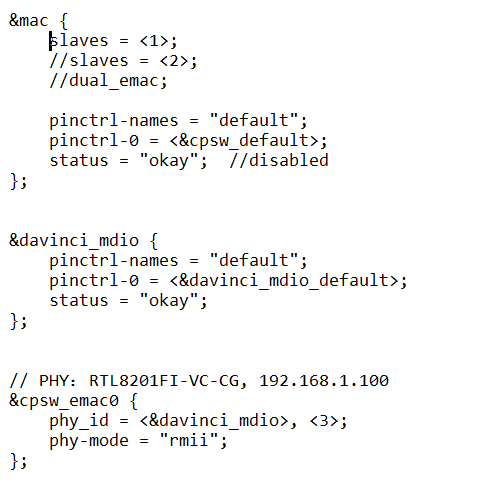

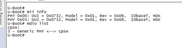

In u-boot, use mii command, it can find two PHY, but in fact there is only one ethernet with PHY address: 3.
Linux version is 4.19.94,mii configuration in dts:

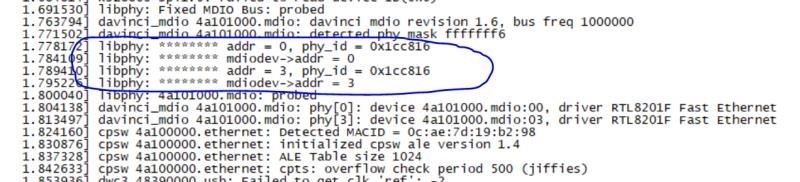

In kernel, MDIO find two PHY too.
What's reason it can find the address 0 PHY?

    The SDK is ti-processor-sdk-linux-rt-am437x-evm-06.03.00.106-Linux-x86-Install.bin, the version of Linux kernel is 4.19.94.
    Customer doesn't want to set cpsw in switch mode. He configured the dts according to am437x-gp-evm.dts, the PHY address is set to 3 by hardware.
    It is abnormal when setting the phy address to 0, it is able to ping the target of the PC, but a lot of packets are lost; When setting
    the phy address to 3, it is also able to ping the target of the PC, a lot of packets are also lost.

    I agree that is not correct to see two PHYs listed if there in one PHY on the board. This could be a board issue. In the link in the previous post is a request to provide the results of the statistics of the MAC. Typically this would ethtool -S eth0. This can be used to see what kind of errors are happening that could be causing the packet loss.
