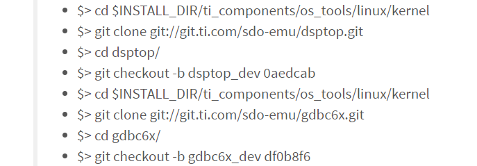

    I follow these steps.
    • download gcc-arm-8.3-2019.03-x86_64-arm-linux-gnueabihf.tar.xz under $INSTALL_DIR/ti_components/os_tools/linux/arm/
    • $> cd $INSTALL_DIR/ti_components/os_tools/linux/arm
    • $> tar –xvf gcc-arm-8.3-2019.03-x86_64-arm-linux-gnueabihf.tar.xz
    • sudo apt-get install Ssh, corkscrew, gawk, uname, sed, u-boot-tools, dos2unix, dtrx, git, lib32z1 lib32ncurses5 lib32bz2-1.0 libc6:i386 libc6-i386 libstdc++6:i386 libncurses5:i386 libz1:i386 libc6-dev-i386 device-tree-compiler mono-complete lzop.
    uname, dtrx, lib32ncurses5, lib32bz2-1.0 are not in the source of the ubuntu 20.04. so it can not be installed and some related tools has beed installed. however. in the following building steps, it did not reported an error.
    • $> ./PROCESSOR_SDK_VISION_XX_XX_XX_XX_setuplinux.bin
    • $>vi /home/<username>/.gitconfig
    • [core] gitproxy = none for ti.com gitproxy = /home/<username>/git-proxy.sh
    • $>vi /home/<username>/git-proxy.sh
    • exec /usr/bin/corkscrew proxyle01.ext.ti.com 80 $*
    • $> git config --list
    • core.gitproxy=none for ti.com
    • core.gitproxy=/home/<username>/git–proxy.sh
    • $> ./hlos/scripts/linux/setup_linux.sh
    • Download Linux file system tisdk-rootfs-image-dra7xx-evm_vsdk_3_8.tar.xz from ti.com and keep under following directory $INSTALL_DIR/ti_components/os_tools/linux/targetfs
    • cd $INSTALL_DIR/ti_components/os_tools/linux/targetfs
    • $> chmod 777 ../targetfs
    • $> tar xf tisdk-rootfs-image-dra7xx-evm_vsdk_3_8.tar.xz
    • $> cd $INSTALL_DIR/ti_components/codecs
    • $> git clone git://git.ti.com/ivimm/ipumm.git
    • $> cd ipumm/
    • $> git checkout -b ipumm_dev 365a9a5402c829710b7e1eefec07d26b3c94c3a9
    • $> Install codec engine ver codec_engine_3_24_00_08 in the following folder <INSTALL_DIR>/ti_components/codecs/
    • download FC version framework_components_3_40_02_07 and installed in the following folder <INSTALL_DIR>/ti_components/codecs/
    • $> cd $INSTALL_DIR/ti_components/os_tools/linux/kernel
    • $> git clone git://git.ti.com/sdo-emu/dsptop.git
    • $> cd dsptop/
    • $> git checkout -b dsptop_dev 0aedcab
    • $> git clone git://git.ti.com/sdo-emu/gdbc6x.git
    • $> cd gdbc6x/
    • $> git checkout -b gdbc6x_dev df0b8f6
    The next steps are all the ones I mentioned before
    Fristly, change the Rules.make, let MAKECONFIG= tda2ex_17x17_evm_linux_all
    Next execute the command
    • make linux
    • make linux_install
    • make -s -j depend
    • make -s -j
    Then tar the file system and keep it in $INSTALL_DIR/vision_sdk/binaries/$(MAKEAPPNAME)/<MAKECONFIG>/hlos/linux/boot folder
    and change the uenv.txt  fdtfile=dra7-evm-infoadas.dtb -> fdtfile= dra71-evm-infoada.dtb for tda2ex_17x17
    Finally format sd card, then execute this command
    sudo ./hlos/scripts/linux/mksdboot.sh --device /dev/<parent_device_name> --appname <MAKEAPPNAME> --makeconfig <MAKECONFIG>
    that's all,  thanks
