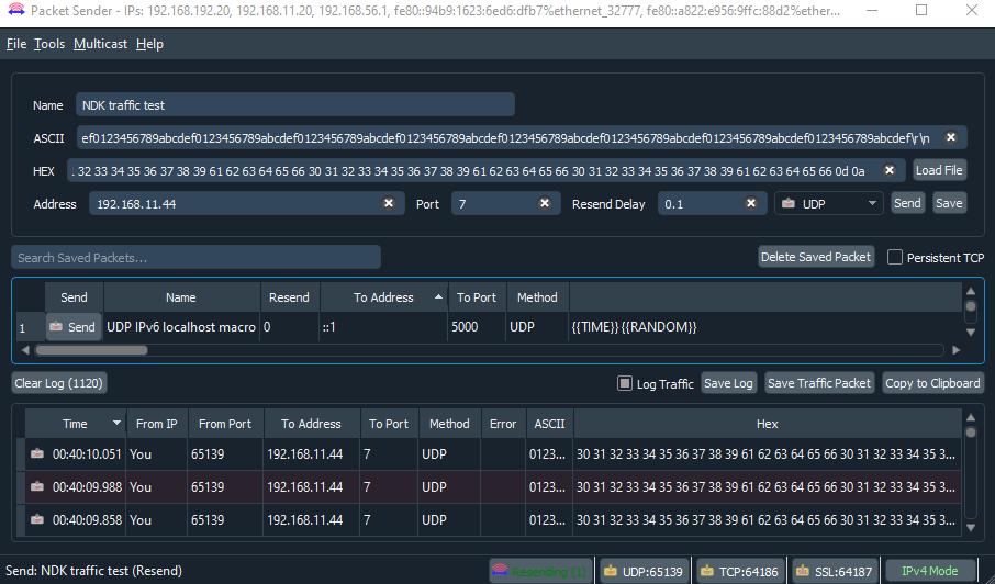

Procedures to reproduce the issue:
1. Download packet sender packetsender.com/download
Fill the "ASCII" field with 1024 ascii characters.
Set the "Address" to LocalIPAddr used in helloWorld_k2g.c
Set the "Port" with any port you like. Doesn't have to be the echo port used in this example.
Set the "Resend Delay" to 0.1 (ms).
Set "UDP"
Press "Send"
An example of my Packet Sender screenshot is attached.

    I actually tried to upload the ascii file which can be loaded by the "Load File" button in Packet Sender. But this forum doesn't seem to be able to take such file by either "Insert File" or "Insert Media". However you can create my file content by yourself. It's 64 repeated "0123456789abcdef" sequence without EOF in the file. But the UDP payload content really doesn't matter in this test, as long as the payload is long enough to produce enough traffic and mess up the internal memory/buffer for some reason.
    The frequency of this issue on my end is "always", given the right sequence and timing of step 1 and 2 in the procedures. Basically, you can try letting the packet sender keep resending with 0.1 delay and never stop it. Then I start "Launch Selected Configuration" of K2GEVM.ccxml in CCS, launch c66x core, load the example binary to the core, and run it.
