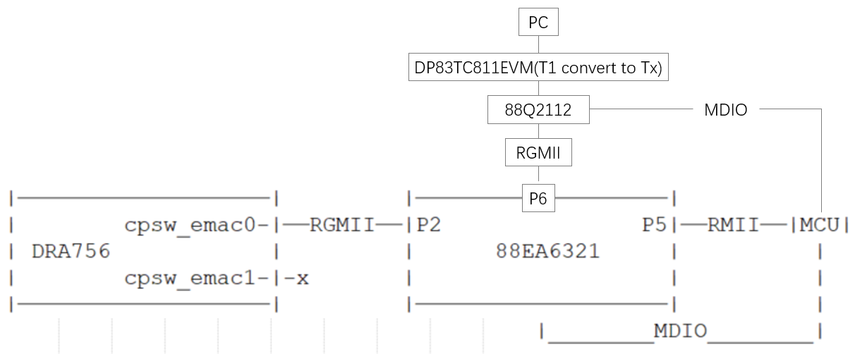

# Hardware connection
There is a DRA756 customed board. Its ethernet connection is shown below.
- DRA7 is connected to Marvell Switch 88EA6321 port 2 through RGMII, which is set with Linux fixed-link {100Mbps, full-duplex}
- MCU connects to port 5 through RMII. MCU powers on at frist and configure switch and phy (Marvell 88Q2112) through SMI clause 22. Then MCU powers on DRA7
- Marvell PHY 88Q2112 connects to port 6, on the other side of which is connected to a PC with DP83TC811EVM
- This local network is not connect to external network.
- MCU is running bare-metal code without IP stack

- "the sent data" is from DRA7 chip with command below. PC ip (169.254.102.129) is determined by DP83TC811EVM
ifconfig eth0 169.254.102.120 netmask 255.255.255.0
ping 169.254.102.129

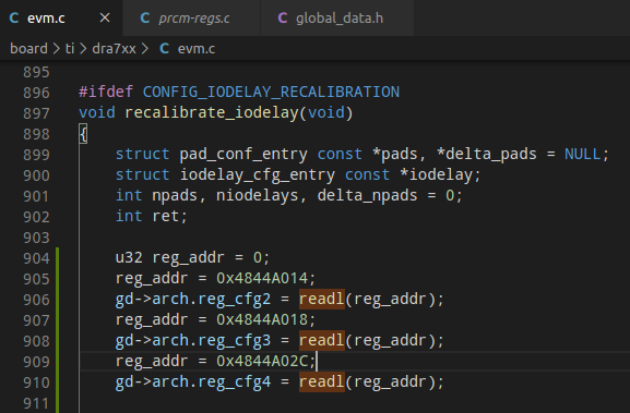

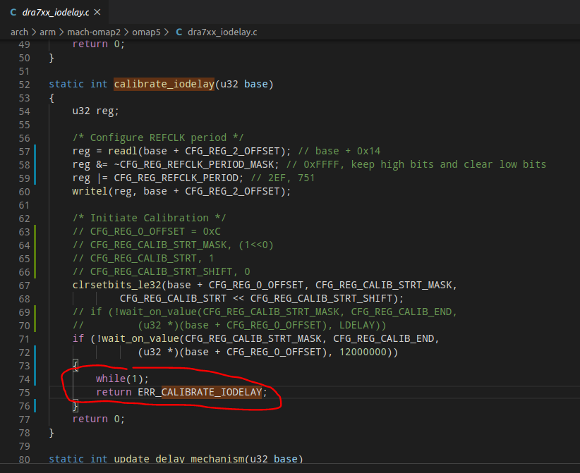

- iodelay recalibration part in DRA7 is bypass. Because the recalibration function returns error. More details can be found here[1]
- port 5 and port 6 data communication is verified, which means both side can send and receive the other side data.
- port 2 and port 6 are configured in the same way, which is forced speed with 100Mbps and forced link
- "not valid" means that data from DRA7 into port 2 cannot egress from any other port. But port 2 is able to receive data from other ports
- Even if VLAN table bit is set, the sent data from DRA7 into port 2 hope to send to DRA7 by port 2 again. However, there is no data shown for port 2 egress pin
- The way I confrim whether there is port ingress or egress data is probing for waveform on 88EA6321 pins
