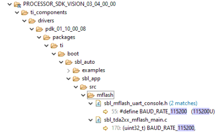

I'm running TI-RTOS Vision SDK v03.04 in the custom board with TDA3x.
Ref: \PROCESSOR_SDK_VISION_03_04_00_00\ti_components\drivers\pdk_01_10_00_08\packages\ti\boot\sbl_auto\tools\mflash
Because of my USB-to-serial converter Baud rates: 300 bps to 1 Mbps.
Try to reduce the 12M of mflash.exe to less than 1M.
In addition to modifying mflash_uart.c
Should sbl_mflash_tda3xx also be modified, where?
Could you please give some suggestion here?
