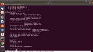

-------------------------------------------------------Ethtool check------------------------------------------------
am335x-evm login: root
root@am335x-evm:~# [   28.408359] cpsw 4a100000.ethernet eth1: Link is Up - 1Gbps/Full - flow control off
[   28.416245] IPv6: ADDRCONF(NETDEV_CHANGE): eth1: link becomes ready
ethtool -s eth1 speed 1000 duplex full autoneg off
root@am335x-evm:~# [   35.687090] cpsw 4a100000.ethernet eth1: Link is Down
ethtool -s eth1 speed 100 duplex full autoneg off
root@am335x-evm:~# [   46.087063] cpsw 4a100000.ethernet eth1: Link is Up - 100Mbps/Full - flow control off
root@am335x-evm:~# ethtool -s eth1 speed 1000 duplex full autoneg off
root@am335x-evm:~# [   58.567097] cpsw 4a100000.ethernet eth1: Link is Down
root@am335x-evm:~# [   78.327091] cpsw 4a100000.ethernet eth1: Link is Up - 100Mbps/Full - flow control off
Note:After booting 1gbps(highlighted in yellow) line is showing Up but once if we check with ethtool we are getting Link is down always.

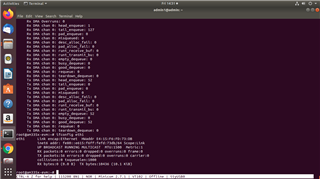

We are bringing up a custom board based on am335x icev2 board.In our custom board we are using DP83867 PHY chipset it’s working on 10/100Mbps speed fine,but when we check 1000Mbps(1G) in ethtool we are getting link is down.what could be the reason and how to resolve this issue.
Here below i have attached boot logs and Dts configuration for RGMII interface please check and revert back us to resolve this issue.

    I attached boot logs for your reference, How to establish link status and provide procedure or reference link.

    The PHYs are being identified so that is a good first indication.
    This Link has an ethernet triage checklist, I would offer to review the list for ideas and to attach the results. Please do not cut and paste into the post as it will make the post very long to read.
    You will need to establish why there is not a link being detected. Use ethtool eth0 to look at the link status, this is described in the checklist.
    Schuyler
  • Hi Schuyler,
    Thanks for quick reply,
    Link is detected and conformed with logs, As per my understand Tx is working fine but RX is not working, Please check the attached logs.
    * Note : I am unable to attach text file.
    Logs :
    root@am335x-evm:~# ethtool -S eth1
    NIC statistics:
    Good Rx Frames: 0
    Broadcast Rx Frames: 0
    Multicast Rx Frames: 0
    Pause Rx Frames: 0
    Rx CRC Errors: 0
    Rx Align/Code Errors: 0
    Oversize Rx Frames: 0
    Rx Jabbers: 0
    Undersize (Short) Rx Frames: 0
    Rx Fragments: 0
    Rx Octets: 0
    Good Tx Frames: 52
    Broadcast Tx Frames: 12
    Multicast Tx Frames: 40
    Pause Tx Frames: 0
    Deferred Tx Frames: 0
    Collisions: 0
    Single Collision Tx Frames: 0
    Multiple Collision Tx Frames: 0
    Excessive Collisions: 0
    Late Collisions: 0
    Tx Underrun: 0
    Carrier Sense Errors: 0
    Tx Octets: 9804
    Rx + Tx 64 Octet Frames: 0
    Rx + Tx 65-127 Octet Frames: 27
    Rx + Tx 128-255 Octet Frames: 8
    Rx + Tx 256-511 Octet Frames: 17
    Rx + Tx 512-1023 Octet Frames: 0
    Rx + Tx 1024-Up Octet Frames: 0
    Net Octets: 9804
    Rx Start of Frame Overruns: 0
    Rx Middle of Frame Overruns: 0
    Rx DMA Overruns: 0
    Rx DMA chan 0: head_enqueue: 1
    Rx DMA chan 0: tail_enqueue: 127
    Rx DMA chan 0: pad_enqueue: 0
    Rx DMA chan 0: misqueued: 0

    You need to prove that the packets are leaving the board first. I would recommend a direct connection between your board and PC running wireshark. I would recommend a PC running Linux.
    You want to see ARP packets from your board to prove that packets are actually transmitted and do not have any errors. You want to see packets returning to the your board with it's MAC address as the destination.
    Schuyler
  • Hi Schuyler,
    Thanks for the continuous reply,
    I connected LAN cable between Board and Linux PC and no packets captured Wire-shark tool so data is not going from board, Please can you help on this issue.
    Thanks and Regards,
    Lakshmi.
    Let's concentrate on eth0 for the moment. Does the ethtool eth0 show that there is a link partner? I think it should since the MAC statistics are showing a packet counts.
    Earlier in the post it was mentioned that you were experiencing the link status going up and down, is that still occurring? It that is still the case then this needs to be resolved first.
    If the link is staying connected then please look at these suggested debug steps. As I mentioned earlier you have to follow the packets, this would be the next step:
    - The MAC statistics are showing a non zero packet count, this indicates that the driver think there is a link partner and there is a link detected.
    - Wireshark is not showing any received packets from your board. So now the reason needs to be found why there are no packets. Look at the MAC statistics using the same command of ethtool -S <ethernet interface> and look for any RX errors like CRC etc. If these errors are occurring then you will need to identify why the packets are leaving the board corrupted. Also bear in mind the packets could be mal-formed as to not even show up as CRC errors for example. I would then recommend attaching to analog side of the PHY on your board to verify data is actually being transmitted.
