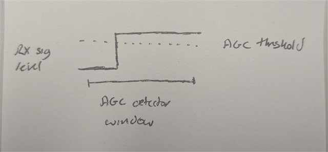

    One question I have is how are you measuring the attack/decay times? Are you sending some signal that would trigger the AGC and measuring the time it takes for the DSA to take effect? One thing to consider is that the winlength parameters are specifying the number of samples that the detector is looking at at any given time. If in these winlength samples, there are more than numHitsAbs samples above the threshold, the AGC will trigger. Then, we would need enough of the offending signal to be in the detector window for the AGC to trigger. This will take some time as new samples are moved into the window and new samples are moved out of the window. I drew some diagrams below to illustrate this:
    In the below example, when the offending signal just starts, there are not enough high samples in the window to trigger the AGC:

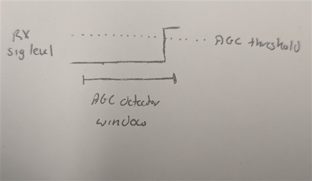

    After a little bit, there are enough high samples in the window to trigger AGC, and the attenuation will be increased:
    So the response time of the AGC will generally be higher than the window length as enough samples outside of the AGC threshold need to move in to the detector window. Beyond this, there will also be some amount of time for the AGC controller to apply the new DSA value, further increasing the response time relative to the window length.
