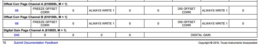

Customer is ADC32RF80 is designed and used.
Fs = 2949.12Mhz
Interleaving spur occurs at 2580.48MHz.
The frequency band you are using.
In this case, is it appropriate to use the command "Steps for freezing the corrector block" in "Freezing and Bypassing the Offset Corrector Block" of Table 120 of the data sheet?
.The value written to Address 6068 in Table 120 does not match the Register Map on page 70 of the data sheet.
Please Check.
70 page
