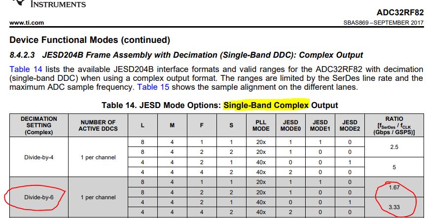

    (4)    From the ADC32RF82 data sheet, I have been observed DA[0,1] and DA[2,3] outputs. Are they quadrature shifted outputs ? Can you explain the relation in timing diagram?
    (5)  If the outputs are quadrature signals , then can I use them as Mixers outputs in the COSTAS loop , as shown in 2nd diagram of attachment?Hardware Realization_KUD.docx
  • 1. With the choice of FS=2457.6M and given the 16-bit resolution for NCO generation, the NCO can be set exactly to 720MHz, same as the carrier frequency in your case. The ADC output will then be at 0IF. I'm not sure what you meant by linking the FPGA to NCO in the ADC. There's no support of external feed for NCO. However, the sysref signal (in JESD204B subclass 1) can be used to reset the NCO phase in the ADC. You can align if you can do the same inside FPGA.
    2. In your case single NCO will be enough. Dual NCO is used when you have more than one band and want to TDD between them.
    3. Yes, single DDC looks enough. The following mode should meet your requirements:
      # of lanes will determine the SerDes rate.
    4, 5. The digitized output is down-converted digitally to give quadrature outputs, same as the digital outputs of a traditional 0IF architecture.

  • You don't need 2 NCOs for IQ outputs. The complex down-conversion in digital is per NCO and gives quadrature outputs as shown in the figure below. NCO generation and the quadrature down-conversion is handled in the device internally.
