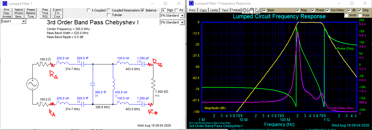

ADS58J63: 2nd Nyquist input circuit
Part Number: ADS58J63
I am using the below given analog input circuit for ADS58J63. I read in one of the forum post suggesting to remove R841, C2946 and R849 if using in 2nd Nyquist zone. Is that suggestion valid for ADS58J63 also?
My sampling frequency is 500MHz
Fin = 250MHz - 500MHz
