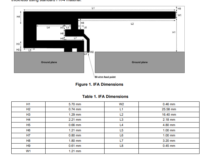

I would like to use dn007 for my application. I wonder If this antenna is a quarter wavelength or not. If yes, which parts should I consider? (L1+H8+H6+H5+H3+H2)
thanks.
Are you trying to tune the antenna? We usually just add a matching network at the feed point and tune the match for final product.
See here:
