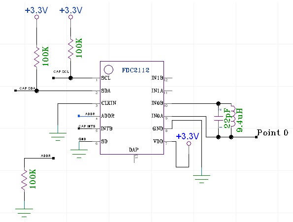

    Have you tried probing the IN0A and IN0B pins with an oscilloscope? If there is no oscillation it could be one of the following:
    • Device is in shutdown mode:
      • Double check the SD pin of the device to make sure that it  is tied low for normal operation
    • Device is in sleep mode:
      • In the CONFIG register, set SLEEP_MODE_EN = 0. (bit 13 = 0 from address 0x1A)
    • IDRIVE settings are not set properly:
      • Increase the IDRIVE setting until you see an oscillation. This could be a sign of a low RP value for your sensor.
    If the device is already oscillating but you do not see data from the device, then check to make sure that your reference clock is set properly. If you do not have an external oscillator but you have the device configured for external oscillator mode then you will not get data. Set bit 9 of address 0x1A to 0 for internal oscillator mode.
    Once you get the inputs oscillating and sending data we can help recommend the rest of the settings. However a good starting point will be to set RCOUNT = FFFF and SETTLE_COUNT = 1024. Set all the divider settings  (FIN_DIVIDER, FREF_DIVIDER) to 1.

    Thanks for the waveform capture. It shows that the sensor is not oscillating, which is likely due to the current drive setting of 0x7800 which corresponds to b01111: 0.146mA. It's likely that the Rp value of this sensor is too low to properly oscillate. First try setting this to 0xF800 which corresponds to b11111: 1.571mA. If you probe IN0A and IN0B, it should look like the following waveform:
    Also note that depending on the sensor frequency value you may need to use the OFFSET and GAIN registers. Refer to section 9.3.2.1 Gain and Offset (FDC2112, FDC2114 only) in the FDC2114 datasheet for guidance.
    Luke

    Please find the circuit connections below:
    KJV
    The schematic looks ok, however can you take another oscilloscope capture and zoom out a bit? Currently the horizontal resolution is only 50ns. Can you go to something like 10ms so you can see if the waveform you are capturing is periodic or just a random noise capture. Also, can you confirm some more about the sensor. Specifically that the sensor is not short circuited or open circuited. Also if the sensor is connected remotely, ensure that the distance is kept short and/or the wires used to connect back to the board are twisted.
    Thanks!
    Luke
    As one added point. Can you confirm that the register settings you write are accepted by the device? Is it possible to read them all back to ensure this is the case? There may be a possibility that your 100kΩ pull up resistors are too large to properly communicate over I2C. Typically we use 4.7kΩ which allows the SDA/SCL lines to charge much quicker. You could try probing the I2C lines to confirm proper communication as well.
    Luke

    You need to adjust the OFFSET and GAIN values to get the sensor frequency in range of the 12 bit DATA register. To get the maximum sensitivity you will need to use a 4bit shift gain setting so you are looking at the 12 LSBs, which corresponds to setting OUTPUT_GAIN[10:9] = 0x3. According the oscilloscope waveform your frequency is around 9MHz. So if your reference frequency is 40MHz, this would produce a 16 bit value of 9/40*2^16 = 14,894, which is outside the 12 bit range. So you will need to use an offset value of around 13,000 to give a reading of 1894 which is a midrange value for the 12 bit window. Now since you are using internal oscillator mode the reference frequency isn't exactly 40MHz and also since you were probing the the pins, the oscilloscope probe adds some capacitance which slows the frequency down. So you may need to fine tune the offset a bit, but that's where I would start. Also since slower sample rate is ok, you should consider using the maximum RCOUNT value = 0xFFFF to get the lowest noise.
