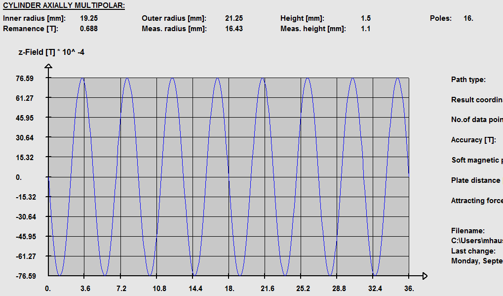

Simulation of my magnet ring in the given mechanical design:

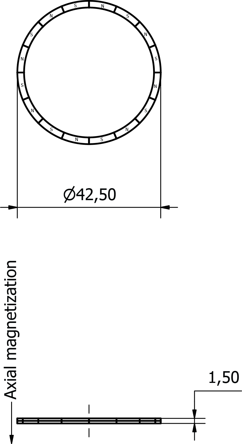

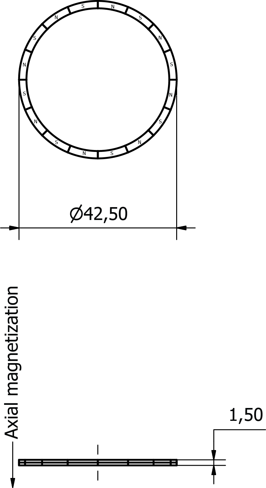

The physical dimensions and outlay of the magnet ring:

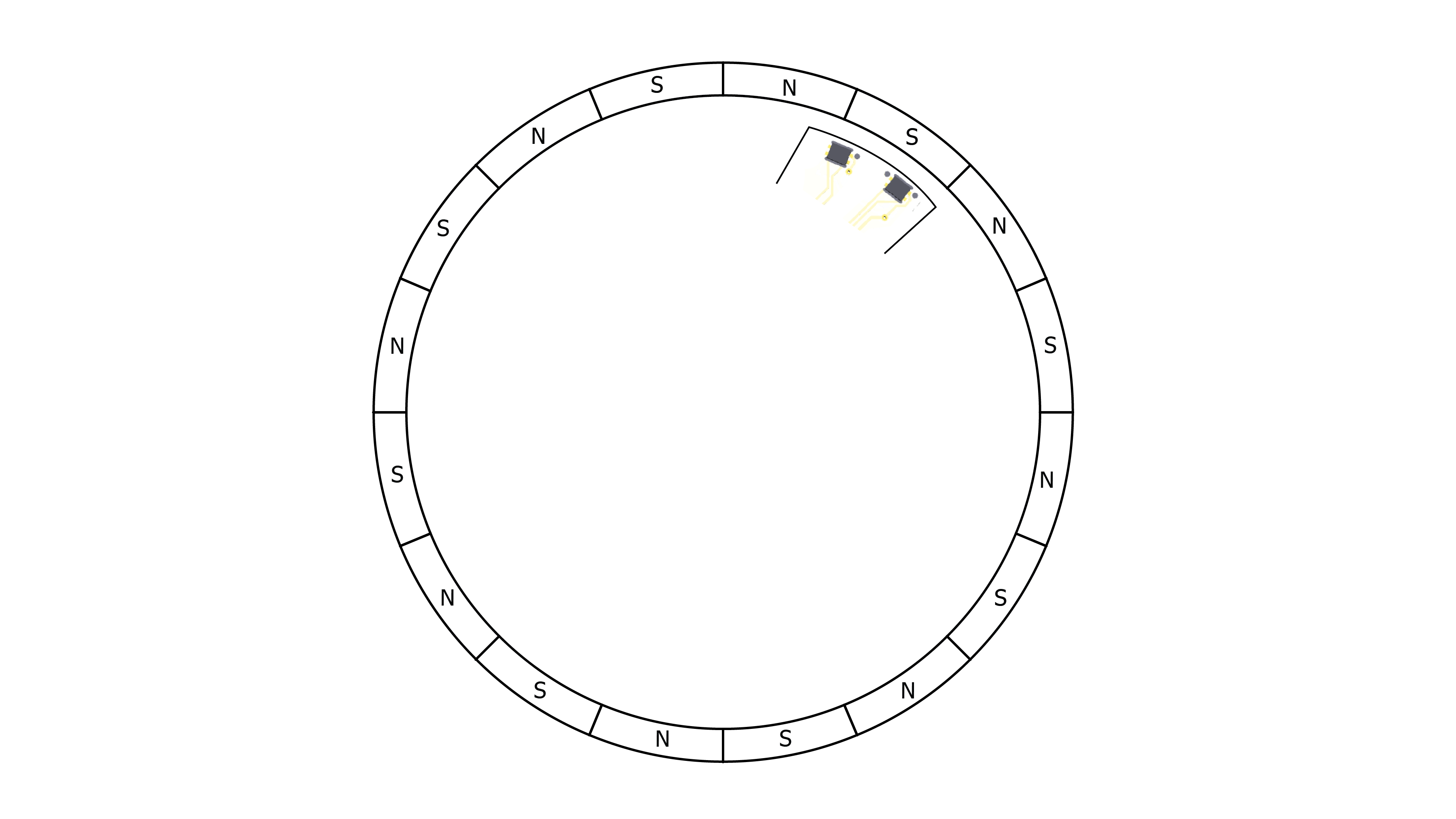

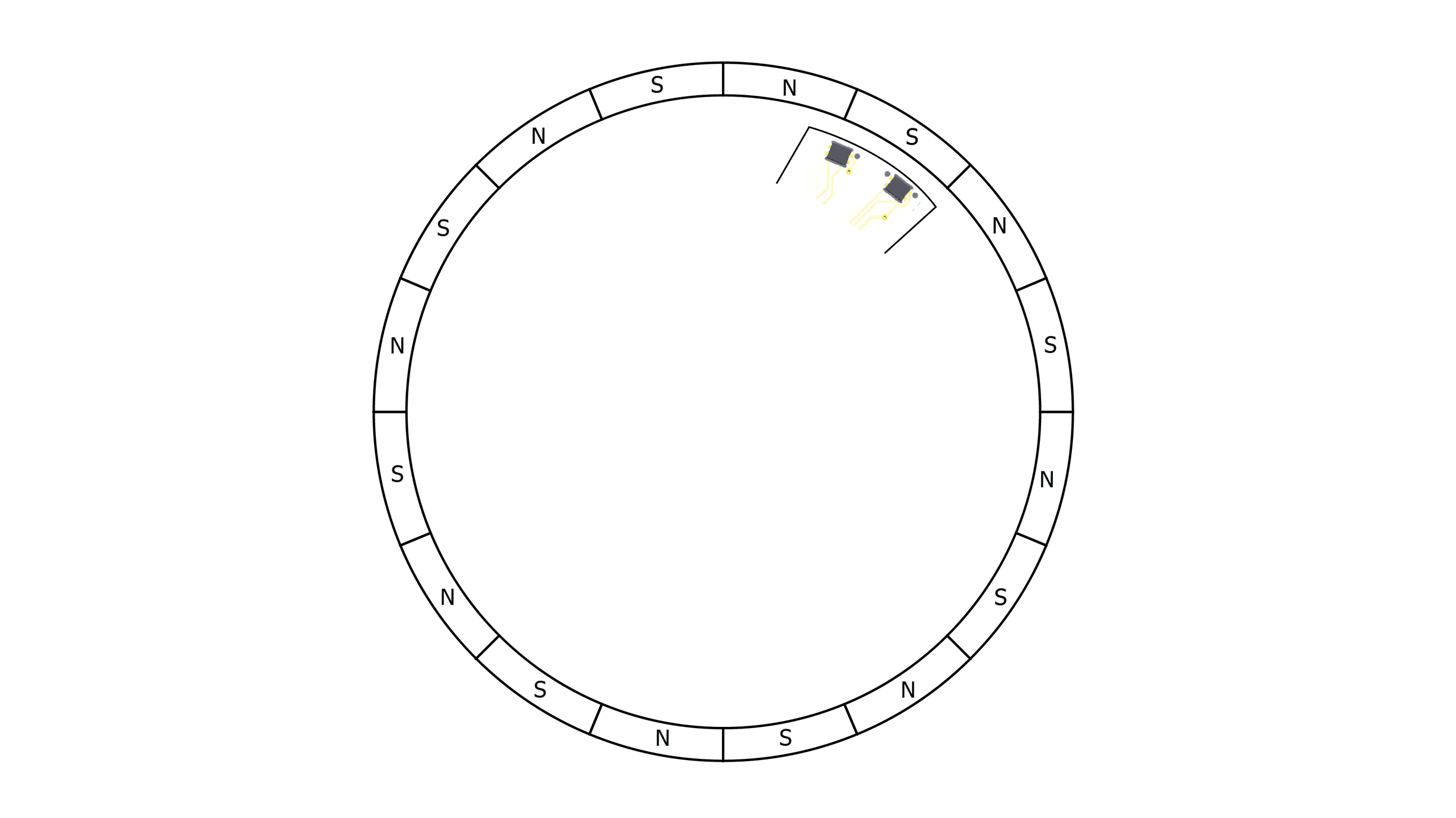

The setup with 2 Halls sensors and the magnet ring:
Wiring of the hall sensors, P16 used for power.:

  • Mathias,
    There is some B-field averaging that occurs when the DRV5032 wakes up every 50 ms.  On a fast rotation, it's possible that the device sees positive and negative B-fields which are averaged to less than BOP, causing the output to be high.  That's one theory.

  • Hello Mathias,
    The "stalling" behavior is most likely an aliasing issue. Basically, to the DRV, the 26Hz input signal looks like a signal with frequency lower than the part's Nyquist rate (i.e. fsample/2), which according to the datasheet is in the range 6.65Hz < fsample/2 < 18.5Hz. So even at max fsample/2, a 26Hz signal aliases to only about 11 Hz and the DRV behaves accordingly. Using a part with a higher sampling rate (such as the DRV5012) should fix this issue.
    Not sure about the saturation over time, however. If it is an independent issue then it will most likely show up on the DRV5012 as well.
