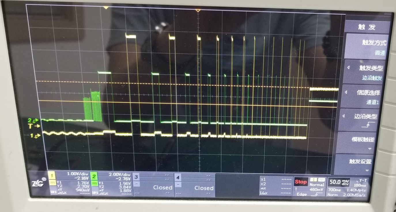

I found DRV421 demagnetization is different from DRV401,  the waveform of  VIcomp in DRV401 is  invariable, it doesn't change with the demag current .
when the demag current is large (Rshunt is small enough  such as 50ohm), drv421 will skip  demagnetization without any waveforms in VICOMP . Is it due to the over saturation of the fluxgate sensor beacuse of
the larger demag current?  as below
Therefore, the magnetization current is difficult to control to ensure the demagnetization is correct

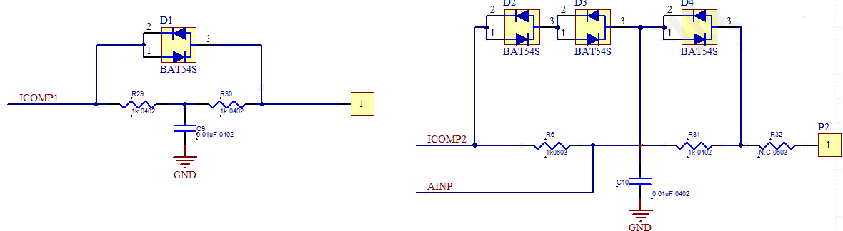

    I use this demag circuit as follows.   The degaussing current is adjusted by changing the value of R32.
    when R32 is 20ohm  ,Rshunt=R6=200ohm,N=200,the ICOMP waveform is as follows,
    But the final output voltage drift  is still exist ,  about  20mV  , .
    With 200 turns you may not have the recommend inductance on the compensation core. Also keep in mind the specification of 8µT is something you will not be able to completely remove.
    If your core gain is 800µT/A at our sensor location. The error on the primary current measurement will calculate as follows.
    8µT/(800µT/A) = 10mA (Primary current error)
    This they calculates as 10mA/200 = 50µA on compensation coil
    With Rshunt = 200Ω there is a 10mV at the input of the differential amplifier
    Therefore after the differential amplifier you can get 40mV.
    Another note:be careful using Schottky diodes as they will limit the measurement range of your and create errors at larger voltages. If the diodes start to conduct at 200mV and because you have two across your Rshunt you will be limited at or below 400mV at the input of the differential amplifier and then limited to 1.6V at the output. Any leakage through diodes will result in an error.

    Can you please check if the degauss is the issue with your core by running the demag with 10Ω or 50Ω as I believe from you previous post that it worked some where in that reagion.  Then change the Rshunt back to 1KΩ.  You can do this by placing an alternate path above your 1k then removing it after the demag function.  For the diagrams you had sent the demag seems to work only with lower Rshunts and the bypass with diodes is not working with the 1K.

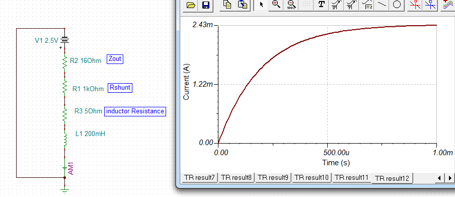

    The degauss operation provides pulses of current through the secondary, with the intention that each pulse will magnetize the core to the opposite polarity and that each polarity reversal will bring the offset closer to 0. In reality it will never reach 0, but it will converge to a much smaller value than what would be present without the degauss.
    In order for this degauss operation to function properly, each pulse from the DRV421 needs to be able to generate a sufficient magnetic field to overcome the residual core magnetization and hysteresis. The magnetic field generated from the core is related directly to the current. The current through the inductor does not instantly change. The rate of change is related to the voltage across the coil, the resistance in series with the coil, and the inductance of the coil. By choosing a large series resistance you effectively speed up the rate at which the current can change. However, you also reduce the maximum B-field the secondary can generate because you have further limited the current. As the device has a fixed degauss duration, it may never actually generate the required B-field necessary to reverse the polarity depending on the charge rate. Alternatively the charge rate may be sufficiently fast, however the current max may not be sufficient to affect the core magnetization.
    The diagram below illustrates the current profile through the inductor over 1ms. Note that the total degauss duration is .5ms with the degauss pulses much smaller than that. Also note that the current is far below the IIcomp typical peak current.
    So this is why Javier recommended you change the resistance. This potentially allows for you to achieve a higher current through the secondary that may be able to generate a magnetic field sufficiently high to overcome the magnetization of the core and the hysteresis.
