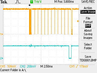

  • Carmine,
    I hope that you got my reply that the evm works even when the DRDY is disconnected.
    I now have some additional information. The DRDY seems to be going low and then high before the read. This trace is with the read. The clock is yellow and the DRDY is blue
    This trace is without the read
    What do you make of it?
  • Hi Micheal,
    Sorry, I didn't get your reply that the evm works even when the DRDY is disconnected.
    In any case this is correct: the EVM source code is the same for HDC1000EVM and HDC1050EVM (where the DRDYn pin is not available), and for this reason the read function is triggered by the DRDYn pin if present (in case of HDC1000) or after a timeout of 16msec (for the HDC1050). So, if you disconnect the DRDYn pin in the HDC1000EVM, the EVM works anyway due to the presence of the 16msec timeout.
    Regarding your screenshot, the behavior of DRYDn pin seems correct: according to the HDC1000 Datasheet, the DRDYn line is set to low when the measurement is complete, and come back to high when the output register is read, or when the next measurement is triggered.
    Please let me know if this replies to your question.
    Carmine
  • On the second screen shot there is no read() so I expected the DRDY to remain low but it does not. It comes back up before the read() starts. Is that what you see?
    So the HDC1050 does not have a DRDY and that is the replacement for the HDC1000?   So there is no reason to factor the DRDY into future software?  It does seem the DRDY is redundant.
    You mentioned the TI software , Is it available to customers? The only software I found was the host software for the EVM and not the EVM to HDC1000 software.  Did I misunderstand how the EVM works??
  • Hi Micheal,
    Maybe I have misunderstood the meaning of the yellow signal: is it not the I2C clock?
    In any case I have done a further acquisition that better explains how the DRDYn pin works. In this acquisition, I have triggered the Temperature reading, pointing the HDC1000 output register at the address 0x00 (it is a I2C write at the register 0x00, followed by no data), and I read the register after 1.6sec. As you can see the DRDYn pin goes low after 12msec from the measurement triggering, and returns high as soon as I start the reading function:
    1) Measurement trigger -> i2c write at register 0x00 (followed by no data)
    2) after 12msec the DRDYn goes low, showing that the data is available:
    3) DRDYn stays low for 1.6sec (please refer to the top of the pictures that shows the complete acquisition), and it goes high as soon as the read procedure starts:
    The HDC1050 is not the replacement of HDC1000/8: they are two different package version of the same device, and for this reason they are SW compatible, except for the Data Ready pin functionality. The Data Ready interrupt is a feature that is present only in the HDC1000/8 version and enables the user to read the data only when it is really available, avoiding to keep busy the I2C bus (in polling mode), or to use a timer to trigger the measurement.

  • Yes the yellow is the clock. The difference between the software I am using and yours is my clock goes and stays low while TIs stays high. My prolonged low clock seems to be triggering the DRDY to go high rather than staying low. I'll have to rewrite the assembler to stay high (I did not write the original). This is not difficult.
