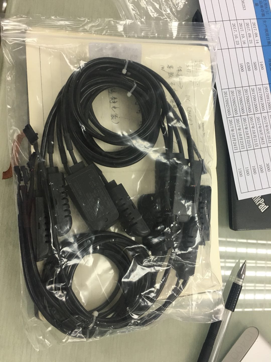

Sensor products: HDC1080 products were produced from 2017 to October and passed the calibration.After the delivery to the end customer, the customer did not use it in time and kept it in the room temperature warehouse for about 10 months

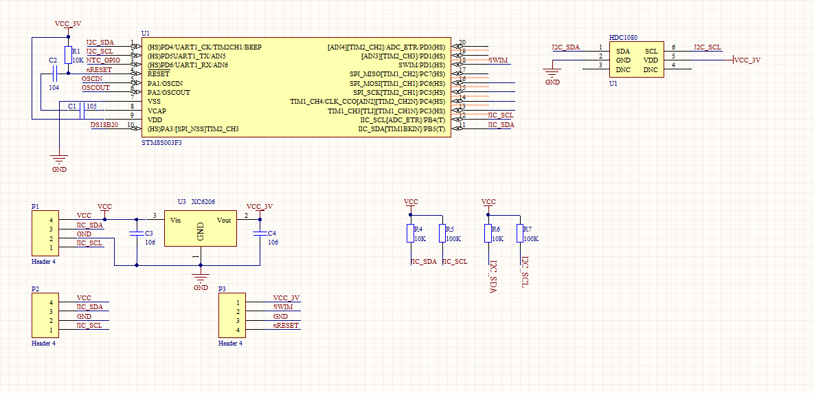

The HDC1080 test humidity was high in the re-opening test, as shown below
Placed in a room temperature warehouse, 10 months later, ready for production.There was a 10% deviation in the laboratory temperature before production
