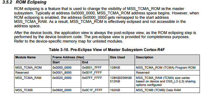

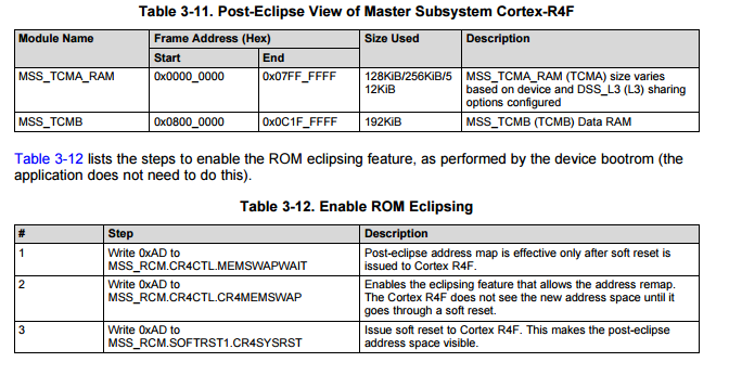

AWR1642: MSS TCM RAM-A memory base address
Part Number: AWR1642
In the SWRU520 TRM, the base address for MSS TCMA RAM is 0x00200000, but in the mmwave_sdk_01_00_00_05\packages\ti\platform\xwr16xx\r4f_linker.cmd, there is below memory map which indicate the base address for TCMA RAM is 0x0. I tested on AR1642 EVM and found the both address point to the same memory, right? But I cannot find relative description in the TRM.
VECTORS (X) : origin=0x00000000 length=0x00000100
PROG_RAM (RX) : origin=0x00000100 length=0x0003FF00
