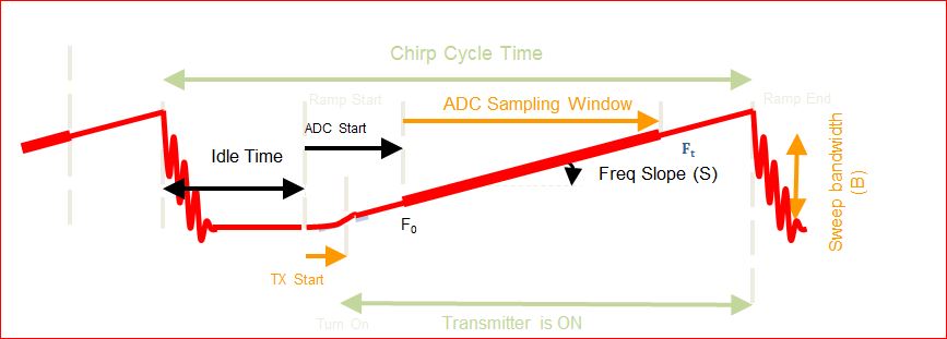

    What is the maximum target velocity for your application? Assuming that typical muzzle velocities can range from 400 Kms/hr all the way up to a few thousand kms/hr (4000 km/hr), it may not be possible to natively measure such speeds as explained in the following post which talks about the basics of velocity measurement with mmWave Radar and the associated limitations.
    e2e.ti.com/.../2251032
    Basically, as given in the above post,
    Vmax = Lambda / 4*Tc, where Lambda is the wavelength (4mm) and Tc is the chirp time. Which means the faster you can chirp, the higher the maximum velocity you can measure.
    Assuming, at the lower end, a speed of 600Kmph, ( ~139 m/sec), the chirp time comes out to:
    Tc = 0.004 / (4 * 138.88) i.e. 6 micro secs, which is too low.
    As shown in the above diagram,  Chirp Time, Tc = Idle time + Chirp time (ADC Start + ADC Sampling + Excess Ramp)
    The minimum Idle time alone needed for ramp bandwidths less than 1Ghz is more than 2us. Similarly, other components of Tc i.e. ADC Start time, ADC sampling time and Excess Ramp time have constraints as documented in this app note which make it impractical to configure a chirp that short.
    That being said, there are velocity extension algorithms that can be run in higher layer software (after detection) that can extend the measurable velocity by a few times the native speed measured by the sensor. You can enter your use case parameters (maximum distance, velocity, velocity resolution etc) in the mmWave Sensing Estimator  to get an idea of the maximum native speed which you can achieve before velocity extension algorithms, based on your requirements.
    -Nitin
