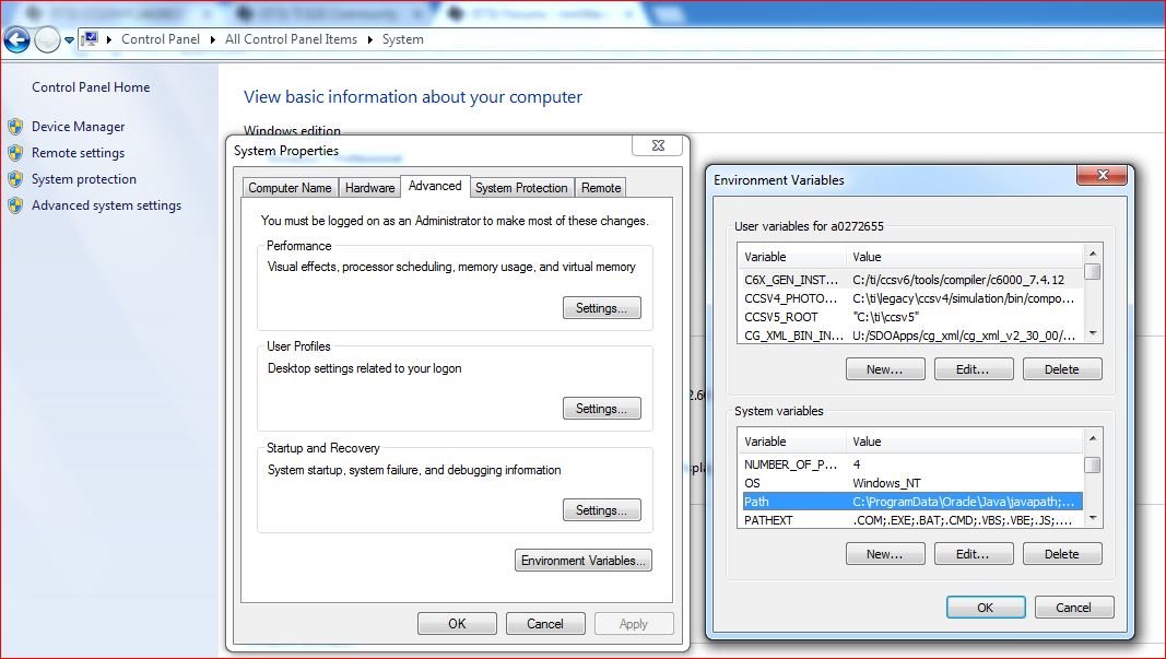

  • Hi Bob,
    I would suggest a few  things:
    As you mentioned, even though you have installed Strawberry Perl, a different Perl installation appears to be taking precedence. To rectify this:
    1. Please make sure that any existing PERL installations are removed from the PC before installing the version of PERL listed in the SDK release notes. Alternatively, to ensure that the correct PERL is always used, you can edit the Windows Search Path (PATH environment variable) to keep Strawberry Perl at the beginning of the Path String (The OS searches this path for the executable and executes it from the first location it can find it in). You can edit the Path as shown below (Make sure to re-launch CCS for the path change to be propagated to CCS and also, please don't forget the semicolon separating the various strings).
    2. Make sure you have CRC.pm downloaded in the right directory as mentioned in the Pre-requisites section of the Vital Signs Demo users guide. Additionally, after you’ve downloaded and saved CRC.pm, locate the saved file and remove the .txt extension if it is there. Please ensure that the file has a .pm extension and not a .txt extension at the end
    -Nitin
  • Thanks
    I changed the order of the windows search path to place Strawberry Perl near the top and now this post build step works OK.
    Many Thanks
    Bob Bacon
