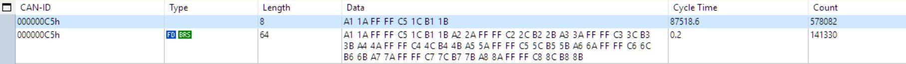

  • Below is the snapshot of the  Classic CAN messages and the CANFD packets without any error in the PCAN application using the MMWAVE-SDK code with just the frametype changes.
    I am not familiar with the microchip CAN analyzer , but I am expecting it to have a settings for the timing parameters . The SDK example is working at 1MBits/s Nominal bitrate with sample point of around 75%.
    Below are the setting we have in the PCAN for the timing parameters
    Have you done similar settings in your microchip CAN analyser?
    -Raghu

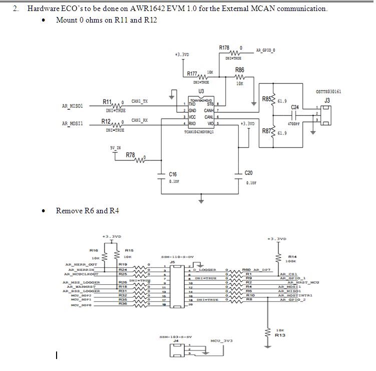

  • Chidvilas,
    You will need to do the below modifications on the AWR1642BOOST for the CAN to be functional.
    By default, the AWR1642BOOST do not have these changes. Please do the modification and you should be able to see the CAN data on the CAN Analyser.
    -Raghu

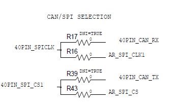

  • Chidvilas,
    The CAN example given in the MMWAVE-SDK is for the CAN(DCAN IP) interface on the AWR1642.    For the DCAN to work on the AWR1642, you will need to perform the below ECO's to the DEVPACK
    DCAN ECO on the Dev Pack:
    1)      Remove R16 & R43
    2)      Mount 0 ohms on R17 & R39
    The CAN-FD example is for the CAN-FD(MCAN IP) interface on the AWR1642 . The CAN-FD application can work to send/receive classic CAN messages(8 bytes) if the frametype set to  "CANFD_MCANFrameType_CLASSIC" which you are already doing. The ECO's required for this to work was given in my previous post , which you have confirmed to be working.
    I am not able to understand why you are getting these errors.

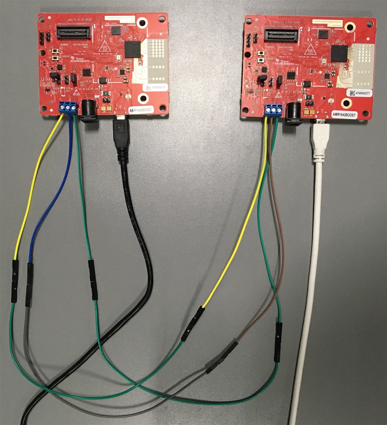

    Can you please send me the pic of your setup with the CAN /CANFD connections and how they are connected to the BUS ?
    Raghu
  • Raghu,
    This is how the boards are connected. I'm running the same code on both of the boards through two CCS instances. I'm running "mcanEVM_EVMtest" with one of the boards transmitting and the other board receiving.
    Note: I've added this line of code "scanf("%d", &MCANMode);" before "if (MCANMode == MCAN_APP_TEST_EVM_MODE_TX)" for selecting transmitting and receiving mode.
    I've started the reception before transmission so that the receiver would be waiting for the message. Transmitter is stuck at the line "while (gTxDoneFlag == 0);" and similarly the receiver is stuck at "while (gRxDoneFlag == 0);".

    I guess the ECO's are incomplete.
    Have you done mounting of 2 resistors and unmounting of 2 resistors on the AWR1642BOOST?
    If the ECO's are done then you should have the external TX/RX working just fine .
    -Raghu

  • Chidvilas,
    The CAN and SPI lines are muxed .
    You will need to remove the R4 and R6 for your CAN lines to work.
    Please do the modifications as mentioned for the CAN to be functional.
    -Raghu
