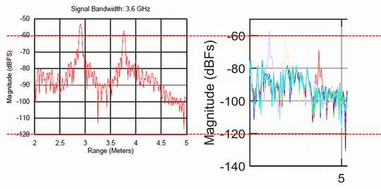

Could you please let me know whether the same corner reflector is utilized for the measurement of indoor and outdoor in swra549?
It seem that the measurement data for indoor has good reflection level. (+10dB)
In other words, it seems the larger RCS of the corner reflector might be utilized for indoor measurement.
