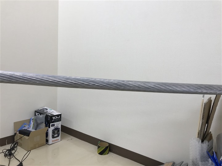

    Are you interested in seeing the wires as lines in the plot? Could you share the current picture? What is the material the wire is made of? Is it metal? Is it smooth?
    In general, if the wire is stationary, no more than a single detected point would be seen. Howver, if the wire is in motion, and is made of metal, and rough, I'd expect to see more detections.
    ANil

    Thank you very much for the answer. Yes we want a way to visualize the wire in the scene. This is the point cloud visualization, and it's really difficult to "understand" which one is the wire.
    The wire is covered multiple metal lines, the pattern is repititive (Bragg pattern). You can see it in the below picture. The electric line is stationary but the radar will be carried and moved with the drone so basically there will be movement between the electric line and the radar.
    We also think about getting raw signal from the radar and process to get the angle of the object corresponding to the shape of the electric line cover pattern. Is there anyway to do such a thing?
    Thank you very much.
  • Hi Cuong.
    One of the difficulties with radar is that it's angular resolution is dependent on the number of antennas. For e.g., the 1443 has 4 Rx, and 3 tx, antennas. Of these only 12 are used for azimuth, meaning that the azimuth angle resolution is limited to ~15 degrees. What this means is that if there are two reflectors at the same range, and same velocity (as they should be in the case of your test), radar would have trouble distingushing them.
    Fortunately, there may be a solution. Radar has excellent range and velocity resolution. Could you mount the radar on your drone, and repeat the experiment?
    Since the drone is moving w.r.t to the wire, the parts of the wire would be resolved in velocity and range. It is possible then for the shape of the wire to become apparent. If you don't have an active drone, could you try placing the radar on a moving platform and simulating the experiment.
    Anil
