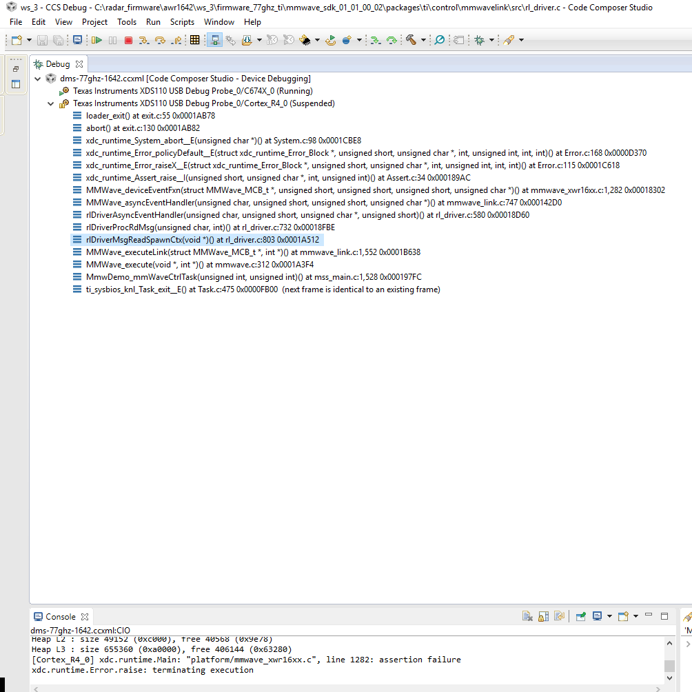

I've been trying to solve an intermittent issue seen when rapidly repeating "sensorStart" then "sensorStop".
I've only recently been able to recreate the issue with only a few modifications to the stock mmwave demo source code. I believe the key is decreasing the frame period so frames are repeating as fast as possible. In most of the applications I've seen this issue, I've been using frame periods such as .5ms, 1ms, or 10ms.
These are the steps I took in the mmwaveDemo default source code to recreate the issue through the debugger:

  4. Configure the sensor once with those settings
  5. Use a terminal program such as RealTerm to repeatedly send "sensorStart" then "sensorStop" with 25ms in between each command.
After a non deterministic amount of time, either the MSS hangs waiting for sensorStop to complete, or an exception below is shown:
Do you have any thoughts on why this could be happening?
