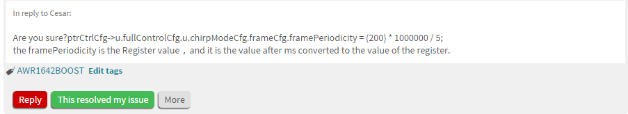

  • I think the framePeriodicity is the  Register value.So framePeriodicity *5= xx(ns);and ramePeriodicity *5/1000000= xx(ms).Are you understand my expression?
    Thinks!
    In order to understand how the framePeriodicity is computed, it is helpful to start with the mmWave SDK demo cli processing.
    The framePeriodicity is defined in ms in the profile. After that the cli code in the mmWave demo converts it to register values
    thank you
    Cesar
