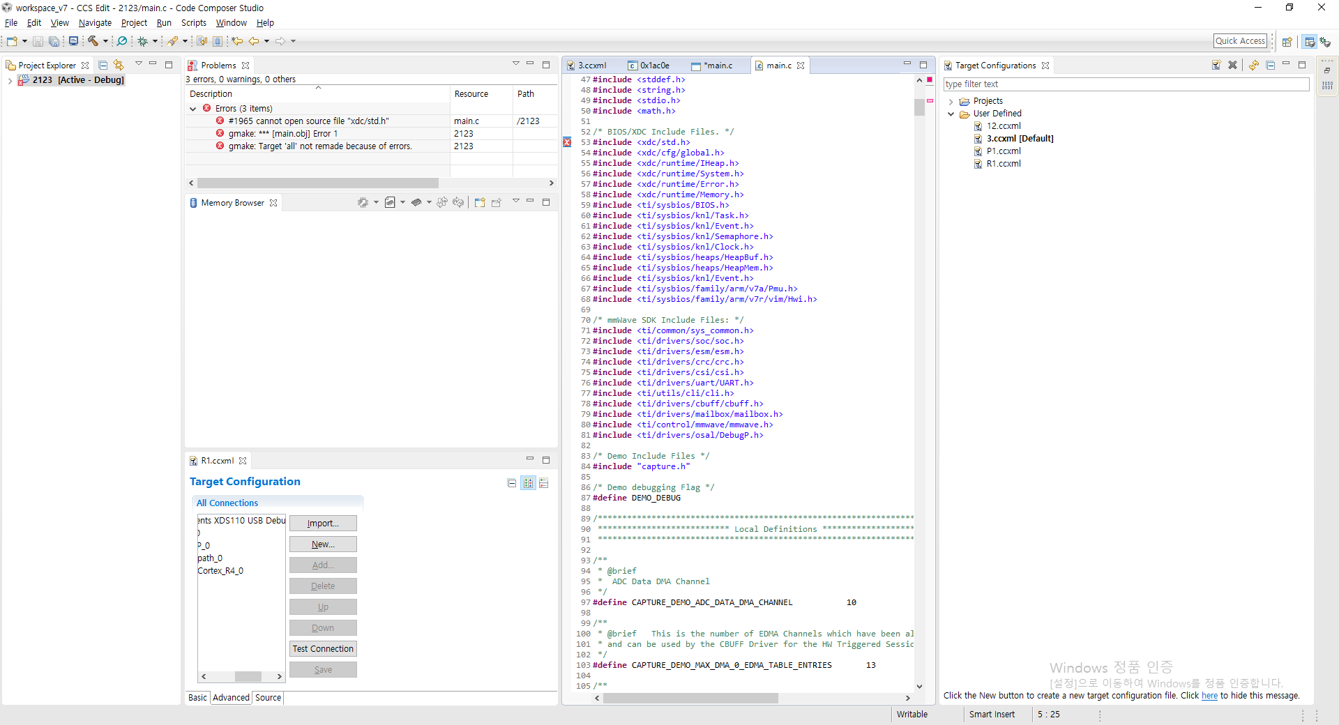

  • Sorry for late reply Justin
    I can run hyperterminal and I did 3.3.2 4_b
    but I cant see global variable gCaptureMCB.stats in CCS Experssions window.
    there are nothing on my window....

  • Thanks Justin for reply
    can I know how to run demo in CCS more in detail?
    including main.c
    I can only make target configuration file....
    when I run main.c, occurs header file error
    xdc folder headers...
    I think I missed something with installing programs but I cant know what's wrong...
    sorry for asking basic queation. It's my first time using radar. So... I need to learn lots of thing
  • Hi Sangwoo,
    Since this is your first time working with TI's radar devices, I would suggest starting with the Out of Box Demo.  There is an instructional video here that walks through running it.  You can also check sections 2 and 3 of the mmwave sdk user's guide.  Work through this to make sure you have properly set up your development environment.  Once done, you will find it much easier to jump into raw data capture.
    Justin
