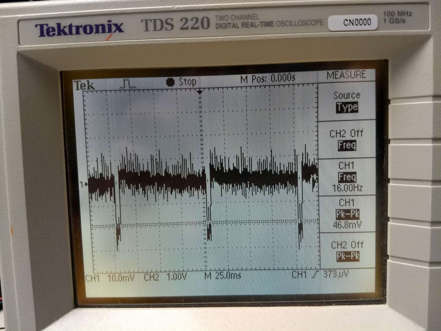

I am trying the mmWave LAB Object Data Over CAN. Before I get a PCAN cable, I setup the system to work with NVidia TX2 which has a CAN port. The system I use is Ubuntu 16.04, the code uses CAN Socket. Anytime when reading the socket, always return -1. Connected to a oscilloscope, I cannot see a CAN signal (see attached, the pulse is only 20mv). I had followed the instructions in section 2.3.3 of document swru508b.pdf to populate R11 and R12 resisters with 0 Ω; and removes R4, R6, R28, and R63 resistors.

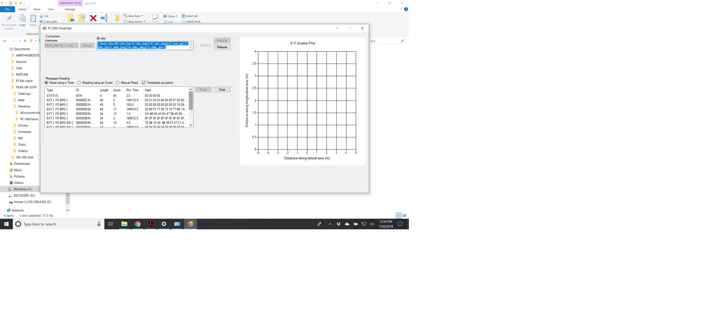

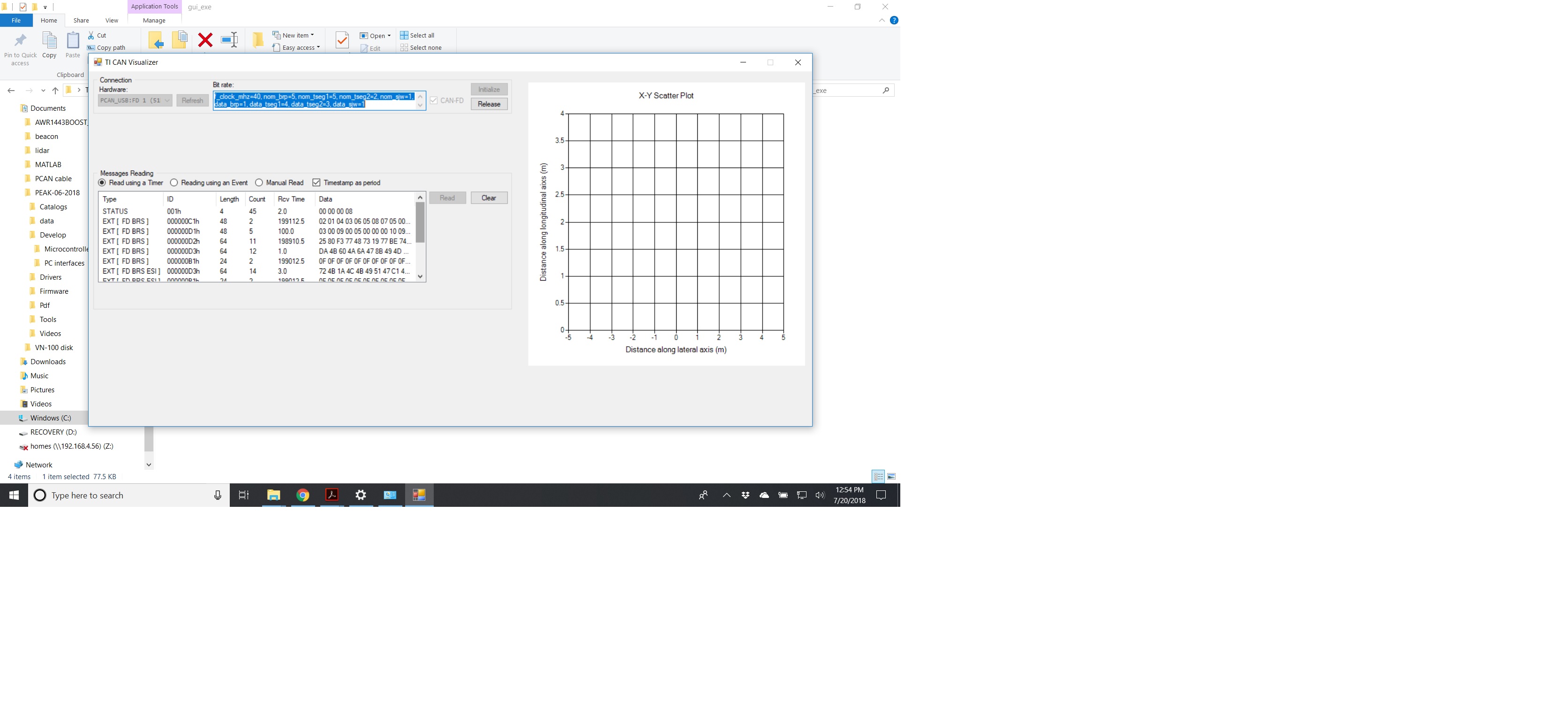

  • Got PCAN cable. Test with my other CAN network, it works. Then connect to CAN bus of AWR1642BOOST, got some messages, then it froze and there is nothing on the X-Y Scatter Plot. Here is a screenshot from "TI CAN Visualizer".
  • Hello Tao,
    Are you using the CCS to download the image to the AWR1642BOOST ? Do you see any error in the CCS console when the freeze happens?
    -Raghu
  • I use Uniflash, and got no error.

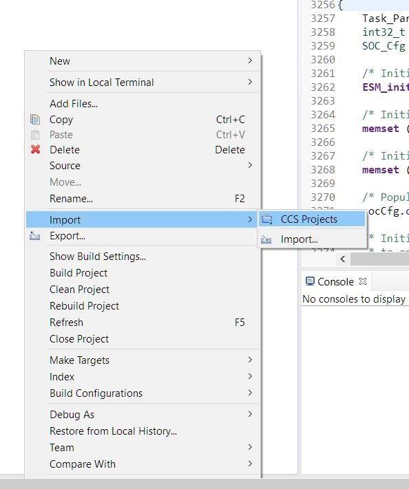

  • Hello Tao,
    The pre-built binaries for AWR1642BOOST in the project works fine on my setup and do not see any issue with those binaries of  loss of CAN communication.
    To build the project you can import the CCS project and select the "odoc_16xx_mss" and "odoc_16xx_dss" from the "mmwave_automotive_toolbox_2_1_2__win" toolbox.
    The you can do the required modifications to remove the "TIDA_1570" as mentioned in the previous post and rebuild the code .
    -Raghu
  • Hello Raghu,
    Thanks for your help!
    I notice in the pre-built binary there are two folders: TIDA_1570 and AWR1642BOOST. And after re-flash today, it works fine with the PCAN cable on Windows. I also did the rebuild in CCS, it also works.
