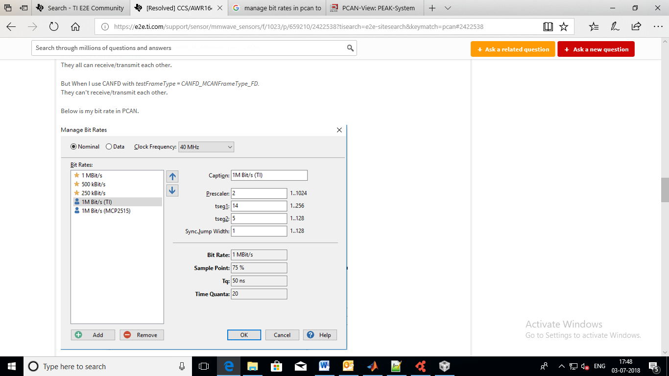

we are using AWR1642boost with label XA1642ABSABL ES2.0 label . we downloaded relevant sdk i.e 02_00_00_04.we are using short range radar code with CANFD driver to transmit radar in CLASSIC FRAME format.I have attached pcan tool settings below.
what we observe that if the detected objects are around 40(>31) ,pcan view  trace gets stopped logging.I have attached can_send() function we are using below.we have fdmode ,brs registers set to 0, dar register set to 0 in mcan initialization and all hardware changes are taken care.Our observation is from multiple logs which we did not see with old awr1642 boards. please look into below queries.

  • Hello Tulasikrishna,
    This ticket is being assigned to concern expert. He'll get back to you soon.
    Jitendra
    Do you want to use single message identifier and transmit all the data ?
    Is there a reason you would not like to use the FD mode of operation?
    -Raghu
