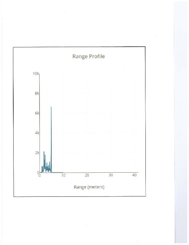

    3.  I got the high accuracy gui and binary going. Attached is a pdf showing the range.  It appears that it only has a range of 5 meters but the two supplied configuration files indicate a much larger range (18 and 33 m, I believe).  Your thoughts?

    Q3: I'm not sure why. I need to run it myself and get back to you. In the meantime, could you check the max range value setting in the visualizer?
