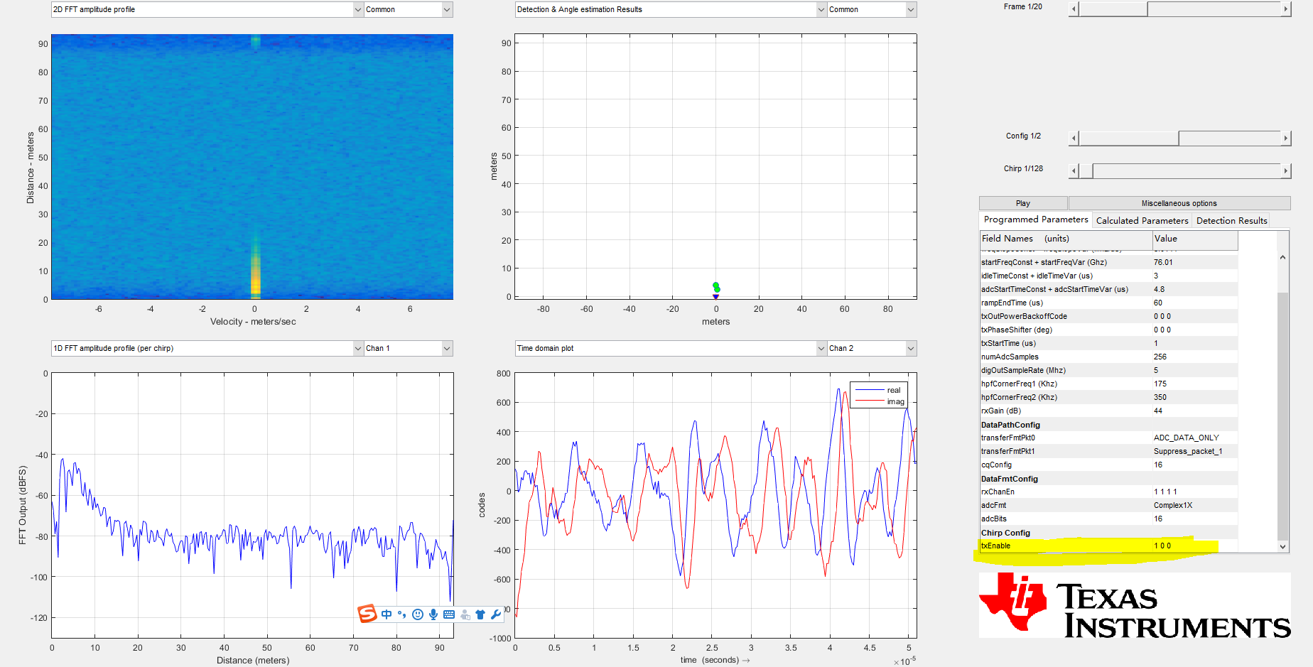

                                                                                            (1) config chip0/chip1/frame
                                                                                                                                    (2) PostProc in mmwave studio
                                                                                                                                   fig1
i am using AWR1642+TSW1400.
After config a TDM MIMO frame, i post process the adc data.
in  fig1(1) i config a TDM MIMO frame:
The frame is chirp0_chirp1_chirp0_chirp1_chirp0_chirp1_....
And the TX is TX0_TX1_TX0_TX1_TX0_TX1_TX0_TX1_....
in fig1(2) :in right side of  postproc plot
  i just find txEnable=1 0 0 in programmed parameters.
I config 2 kinds of chirps, Why postproc shows only 1 chirp in programmed parameters.
I think my configuration in fig(1) is right.
Is  postproc right?
