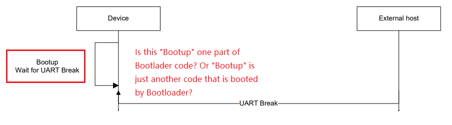

We recently made a research in Awr1642 Bootloader Flow:http://www.ti.com/lit/an/swra551/swra551.pdf.
Paragraph 4.4 shows the flash programming sequence.
Because we want use a secondary boot to handle several Images in flash, and will use CAN/CANFD as an image data transfer port.
So if this "Bootup" is part of Bootloader and "Bootup" is coded "wait for UART break", i had to ask for the source codes of Bootoader and change them myself?

  • Hello Brian,
    In case of the secondary bootloader (SBL) where it listens to image data over CAN/CANFD,  this task is independent of the primary bootloader.
    - Primary bootloader reads sFlash content which is SBL in your case and put it respective RAM and lets it execute.
    - Now SBL needs to be in the loop to listen to app-image data over CAN/CANFD. As it gets any data it needs to validate it and write it to sFlash (pre-defined sector).
    - Developer needs to define section on sFlash for a different type of images and define intelligence to verify receive data in case of any loss/mismatch. This intelligence can be done by following some specific protocol b/w device and CAN download tool.
    Here is the flow diagram to endorse my above statements-
    Next version of mmWave SDK will have an application to demonstrate SBL functionality, stay tuned for that.
