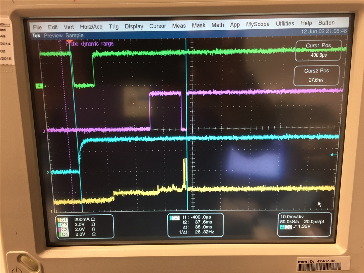

    P.S. I have included the oscilloscope example for new TIDEP Low Power code (with swra577 power supply).
    blue - nRESET
    green - WARM_RESET
    pink - GPIO-0 (application specific)
    yellow - 5v current probe 200ma/div
    If you assert nRESET (=0) the 5v current into the PMIC is >100ma lower.

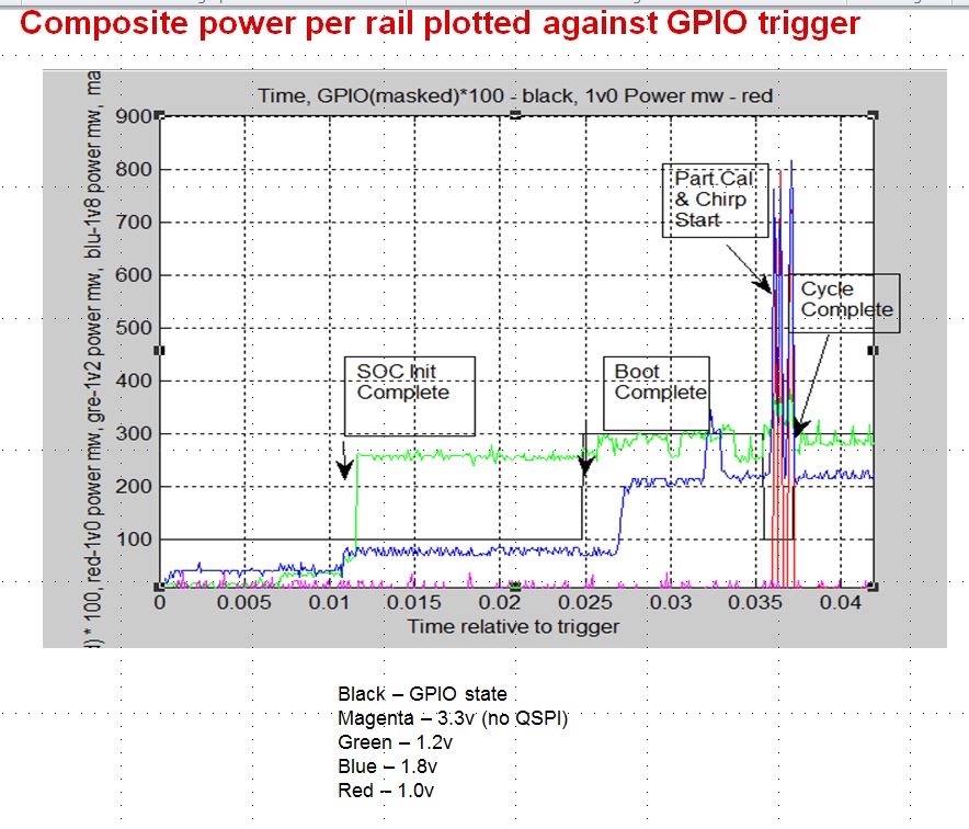

    The EVM would need to be modified to monitor each power rail, I have one example for TIDEP-0091 new Level Sensing code, this will work
    for IWR1443 ES2 (with longer boot time), or IWr1443 ES3 (shorter boot time).  The graph is in mw, you can divide by the rail voltage for current.
    Note: this graph is the power supply monitored, the PMIC power is a DCDC converter, that is Forced PWM for 1.0 (1.3) and 1.8v and PFM mode for others, see LP87524 datasheet.
    1.2v  - green
    1.3v (this is 1.0v for my setup) see swra577 - red
    1.8v - blue
    3.3v - magenta
    time 0 is the 0->1 nRESET release.
    Please see graph attached.
    Joe Quintal
